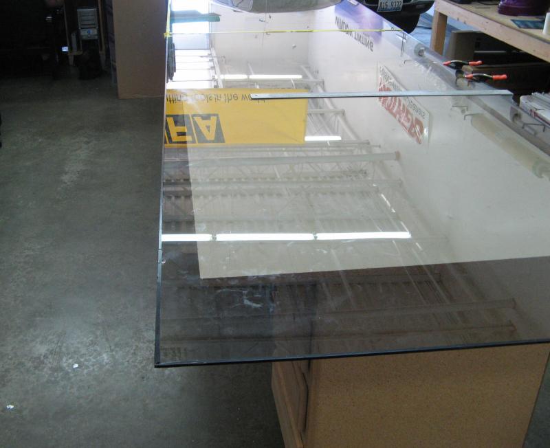

I have 1/4 glass. 2 4x8's. Works great, also have 2 more mounted on wall where we do our cutouts for auto tints. 1/4 will work, but i would get 1/2 next time around. Stainless blades won't scratch glass. Awesome for cutting prints, vinyl etc. haven't done it, but you can print rulers for the glass and install it on the underside, kinda like the rhino cutting mats.

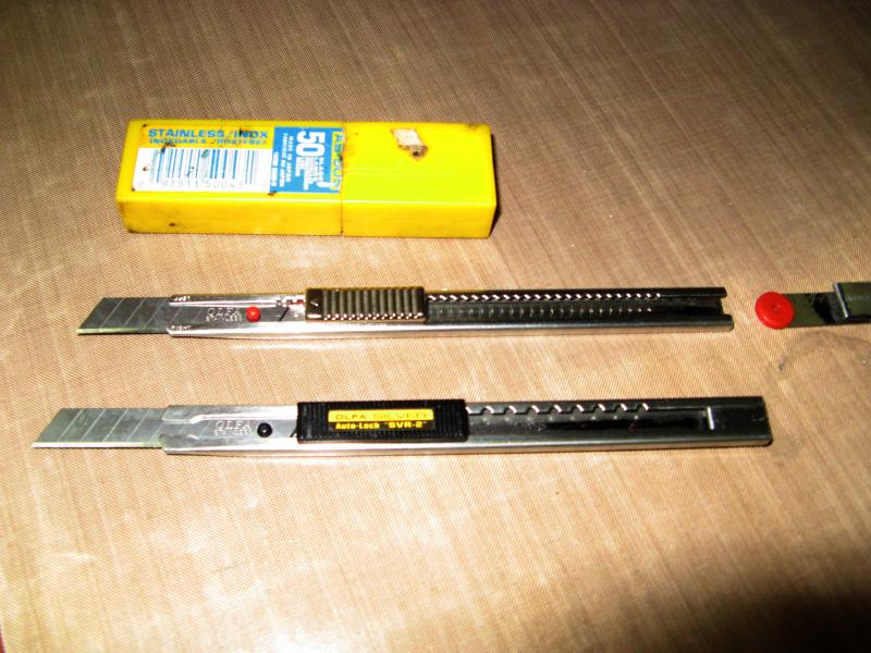

I use olfa, quick break away blades at your disposal. Black one is olfa siver(self lock) & the red one is called the red dot. Perfect for cutting prints, weeding, cutting mags etc, I Bought a pack of 50 stainless steel blades for the knives. xacto is ok, but i prefer olfa, they are built better.( My opinion)You can get the blades w/ sharper angle for harder to reach areas as well. Don't use blackmax on glass. Get a bigger knife for cutting coro or any larger subs.
