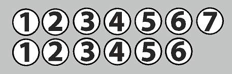

Customer is looking for qty 12, 3.5" round stickers that are glo-in-the-dark for inside door numbers. I thought I could maybe find it in a 15"x10 yard roll ... NOT. I checked Firesprint, Zoo, Signs365, Signs.com, Vistaprint ... no luck.

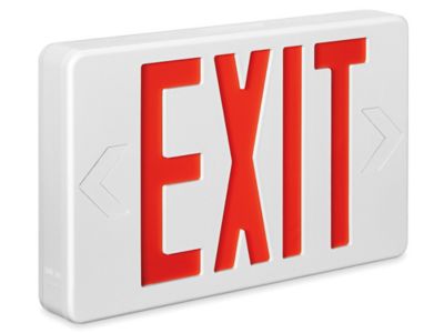

This company is a bit odd, the power went out once and they couldn't find the exits. Apparently all their exit signs were burnt out. I said if the signs are lit you won't need glo-in-the-dark stickers...
What if I spray the decals with glo-in-the-dark Krylon? Will the numbers be visible or would I have to layer this?

sure hope they don't get inspected by the fire marshal............. that's a hefty fine for not having working fire exit signs

isn't working exit signs a fire/osha requirement that is checked and or inspected by the town regularly. we have a fire inspector that comes in our building like 2 or 3 times a year.
they check the extinguishers, smoke/carbon monoxide alarms and our exit/emergency lighting.
