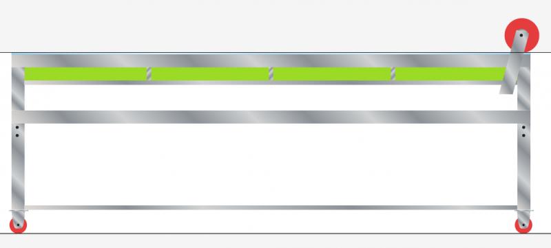

Heh, this is a timely thread. I'm building a killer table too! But I'm making mine a glass top, lighted, with a roller gantry! I'm actually in the sketch stages right now. Still deciding on T-Slots or Welded for the entire structure. I made a bunch of really great improvements to this sketch, I was almost completed, when Illustrator crashed. So, it's back to the first round. (I've been cooling out on this project since it crashed on me Friday, but I'll get back to it) The glass alone will cost me $900!
Where this is going I've only got room for a 5' x 12' max, so it'll probably just end up being 5' x 10', maybe 11'

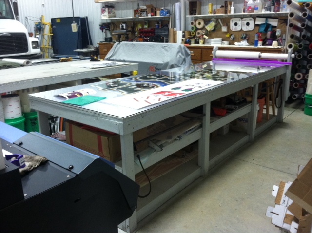

Here's mine. 4' x 12' with tempered glass top. Transfer tape dispenser built into the end. Shelves under neath. Been with me since the begining. If i had to remake it would be 5' wide.

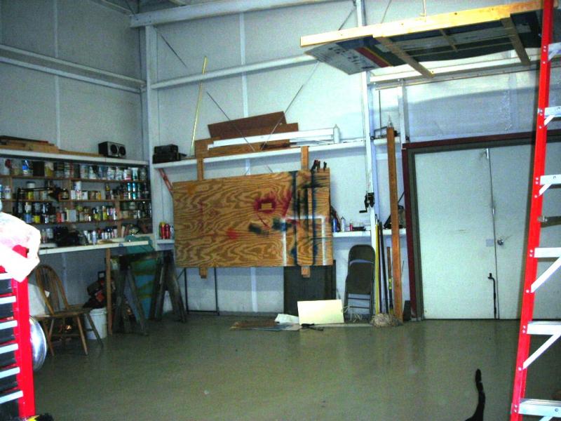

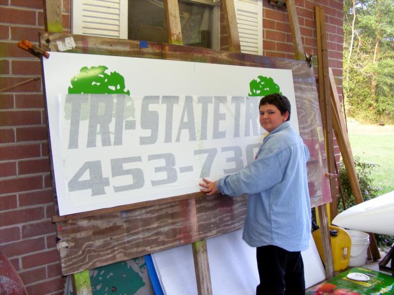

seems the people who do vinyl and prints have no idea of what an EASEL IS!!!!!! us old sign painters always used EASELS..... was so much easier then painting on a flat table......i have 2 here, one at the house and one in the shop. now mine are simple 4 FT x 8 FT........ but they make it easy for a one man operation to work alone.
i have been to other sign shops that have larger ones....most 16-24 foot long. but even for STICKEM LETTERS i find applying them on the EASEL so much easier!!!!
it allows you to see the total sign better, align text easier, and if you apply wet gives the liquid someplace to go. this is a simple one in the shop. in the pic it laying flat to wall but you can see its hung from that horizontal purlin .......i lift the bottom out, and i have 2 drop down boards the will hold the bottom out from the wall at about 15-20 degrees............
the 2nd pic is at the house on the car port. just a couple 2x4's, sheet of 5/8 plywood leaned up against the wall at 15-20%. i have done 3 ft X 16 ft banners on this. the sheet in the pic is a 3 x 6 alumicore.
