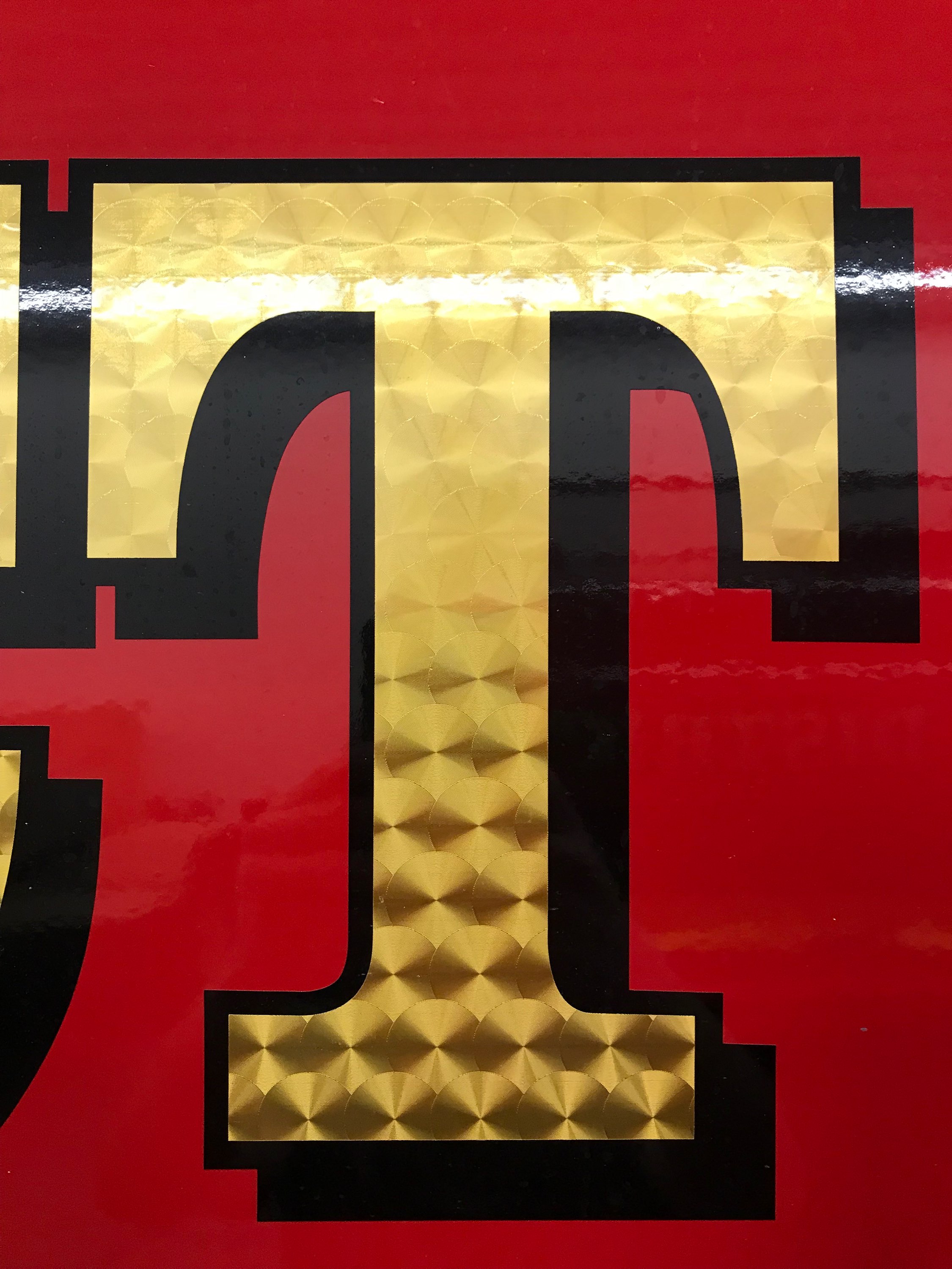

I bought Gold Leaf Foil Large Engine Turned and it is not the same color that is on the other fire engine that we are doing....How do you match colors on it, or is a a dye lot type issue. Just need to know what to tell the customer.

Could be a different manufacturer or different karat if it's SignGold. Then there is the thing called UV degradation (ie: it faded).

Not sure it has an edge like vinyl and it has a fold that looks like it creased on them. The existing one is Very Bright Gold colored where the 22 Karat Engine spun we purchased is a creamier color for lack of a better word. It matches what is on their smaller trucks...but the Big Truck is a very bold color. So I am confused.

Yea, that almost sounds like one of the fake engine turn golds...they are really bright and have reall hard lines in the spinning

There are a few different manufacturers of similar gold vinyls and all of their vinyls are slightly different. They also offer different grades/styles of vinyls within their own brands, so it is best to request swatch books from each to have so that you can compare to what is on their trucks currently to verify you order the right material for the department.

The difference is so different. the almost white looking one is brighter than my 18 karat gold ring...but the other is so Bright

That is not real gold laid by hand. Some sort of brand you buy like SignGold. Didn't one of those companies
split some years back and the guy went to Deland FL to start up another one called RealGold?
Get a hold of RealGold people and send pic you posted and maybe they can help you.

Really hard to tell from photos, but the T looks like either a "fake" gold or even a printed gold effect. The A looks more like Signgold. But as has been said you need swatches from the various suppliers to compare. And those won't help with real gilding or printed fakes.
Neither is real hand laid gold. The “T” is R-Tape VinylFX large engine turn gold. The “A” is Sign Gold. The R-Tape really doesn’t belong on fire trucks.
