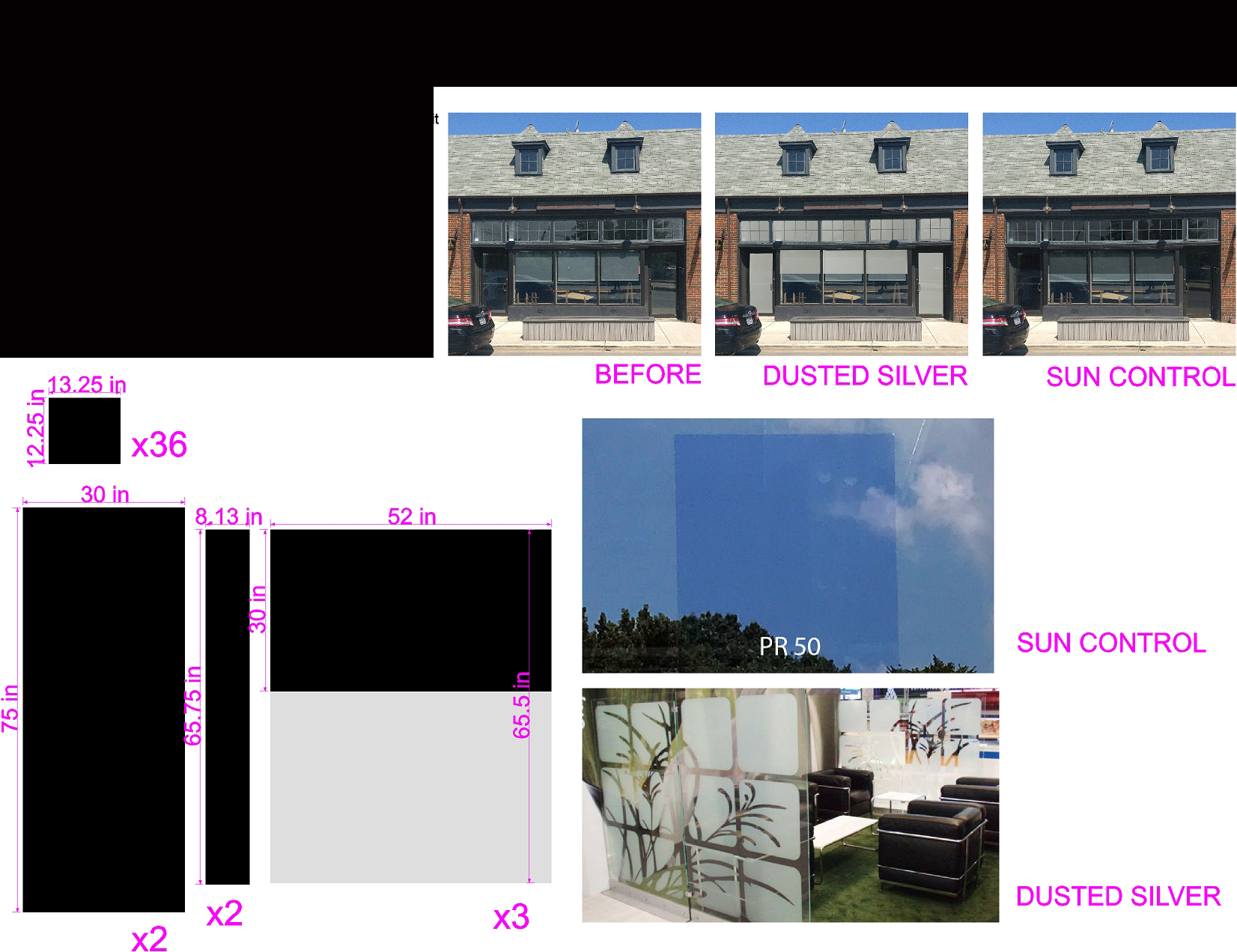

Okay. The client and I were originally talking about etchlook or frosted crystal for the windows to function in the same manner with some added benefit/disadvantage of privacy. They have some really cool stuff they would like outside patrons to see. I was going to design some graphics so this would function as an advertisement and also block the sun. My second thought was why not get some good window tint, install sub-surface and add vinyl graphics to the front of the windows. I have a plotter, why not do it all?
That being said. If I covered these windows with etchlook, would they block any sun or heat? I don't think perforated vinyl is an option.
Why not do it all....you say. Because what you are describing will most likely look like sh!t. Post up pictures of what you wanna do and pictures of the various windows in question, as your description(s) just don't cut it.
I don't see why this shouldn't work well.
i would totally mix it up place the sun control up on the top windows and frost/etch all of the bottom windows and doors but i would not do a solid frost more of the example you have in the picture a cut pattern to break it up a lot
on the bigger 3 windows take note on where your seam will be as i dont think you can get frosted or etch vinyl that wide (48"max)

3M, Avery, and Arlon offer 60" "etched" media. Probably Oracal does, too- but I've never used it.
