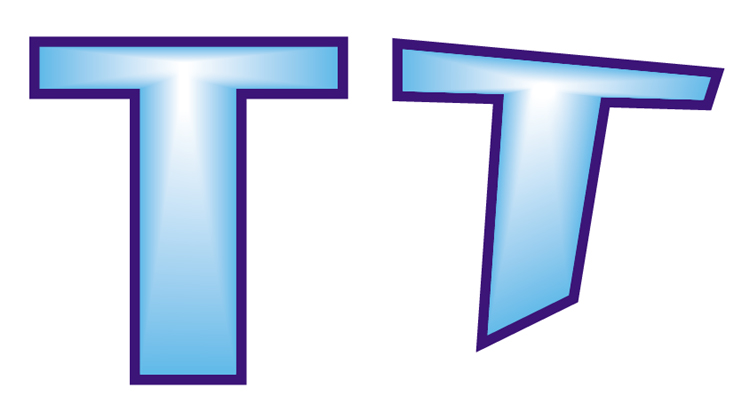

You might want to consider using blends instead of gradients. You have considerably more flexibility with them. Most applications including Illustrator, Coreldraw and Flexisign can do blends with no difficulty.
Some simple examples:

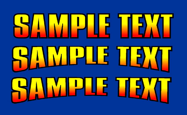

Apply the fill to each letter. Sometimes uncompounding does this.
I wouldn't change the angle especially if you are using a thermal printer

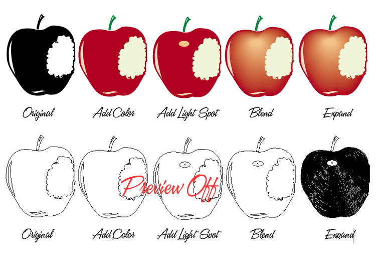

Fred -how'd you do that?
I've been fooling around with gradients and fills for a while and haven't quite figured it out. I see alot of fills that come from the outside of the letter in or vice versa. I only seem to be able to have them come from one direction. I'm using Corel12. help please......
Fred Weiss
Merchant Member

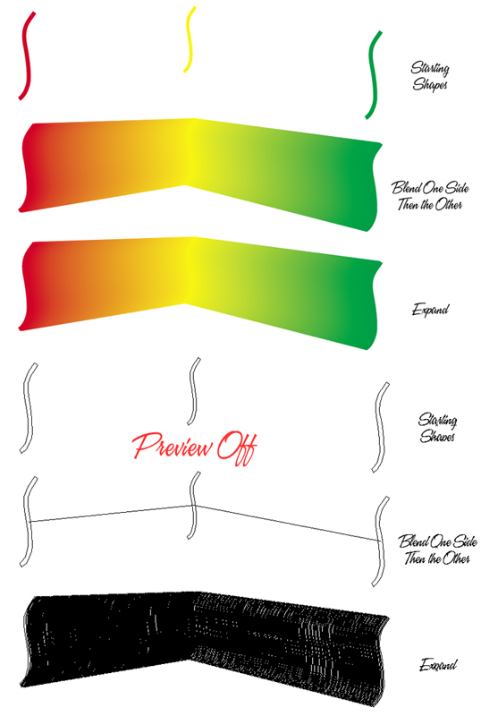

The screen shots below demonstrate a couple of different ways to use blends. They were done in Illustrator, but Corel should work pretty much the same. It's really limited to your own imagination.
Take the time to experiment and practice and you'll get good at it in no time at all.
In example #1, I started with a black and white vector. Next color is applied as desired. Third, a small, internal shape is set where the light hitting the apple is centered. Select the spot and the outside shape of the apple and apply blend. Either shape may now be selected for a color, size or position adjustment. Finally, execute an Expand command to convert the effect to vectors. This is needed so that other applications can correctly import the graphic when needed.
Example #2 we start with three separate shapes, each a different color. We select the center and left shapes and blend then. A duplicate center shape is positioned over the original and used for the right side. Each half can now be adjusted. Finally, expand the result.
