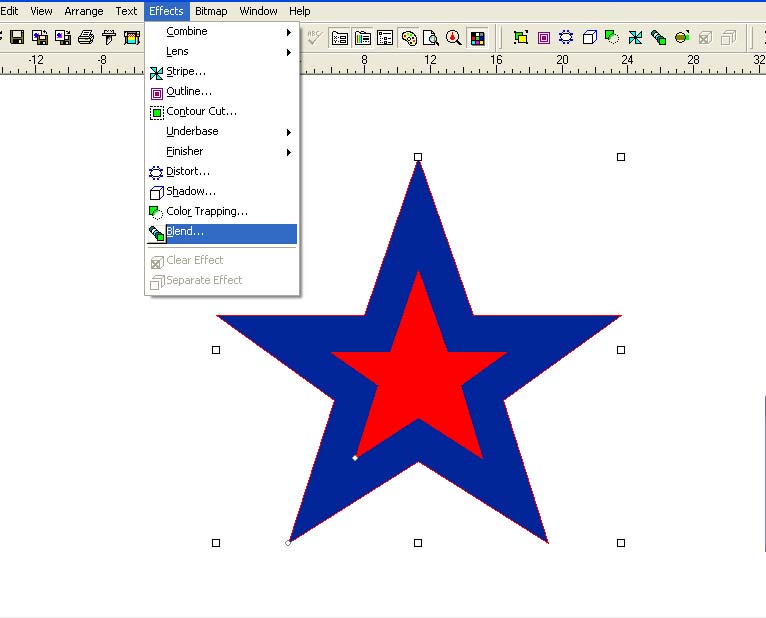

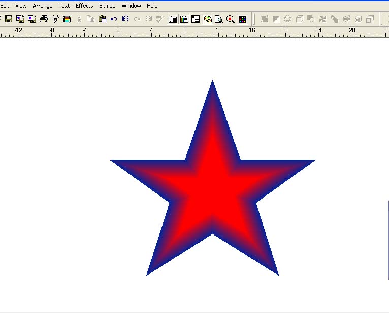

I don't think you can achieve this in Flexi using the gradient tool. The Blend effect might work for you.

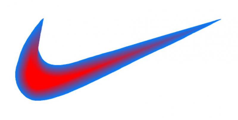

J Hill Designs
i did it on a makeshift crappily drawn swoosh like shape, and it worked well
edit: not completely perfect, but what can you expect I guess...
