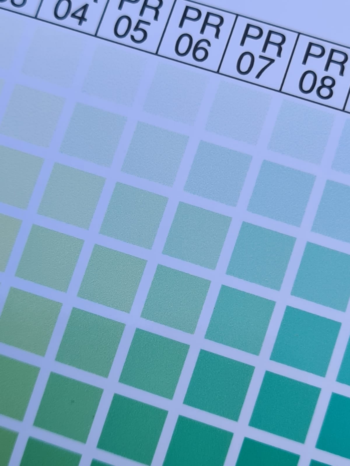

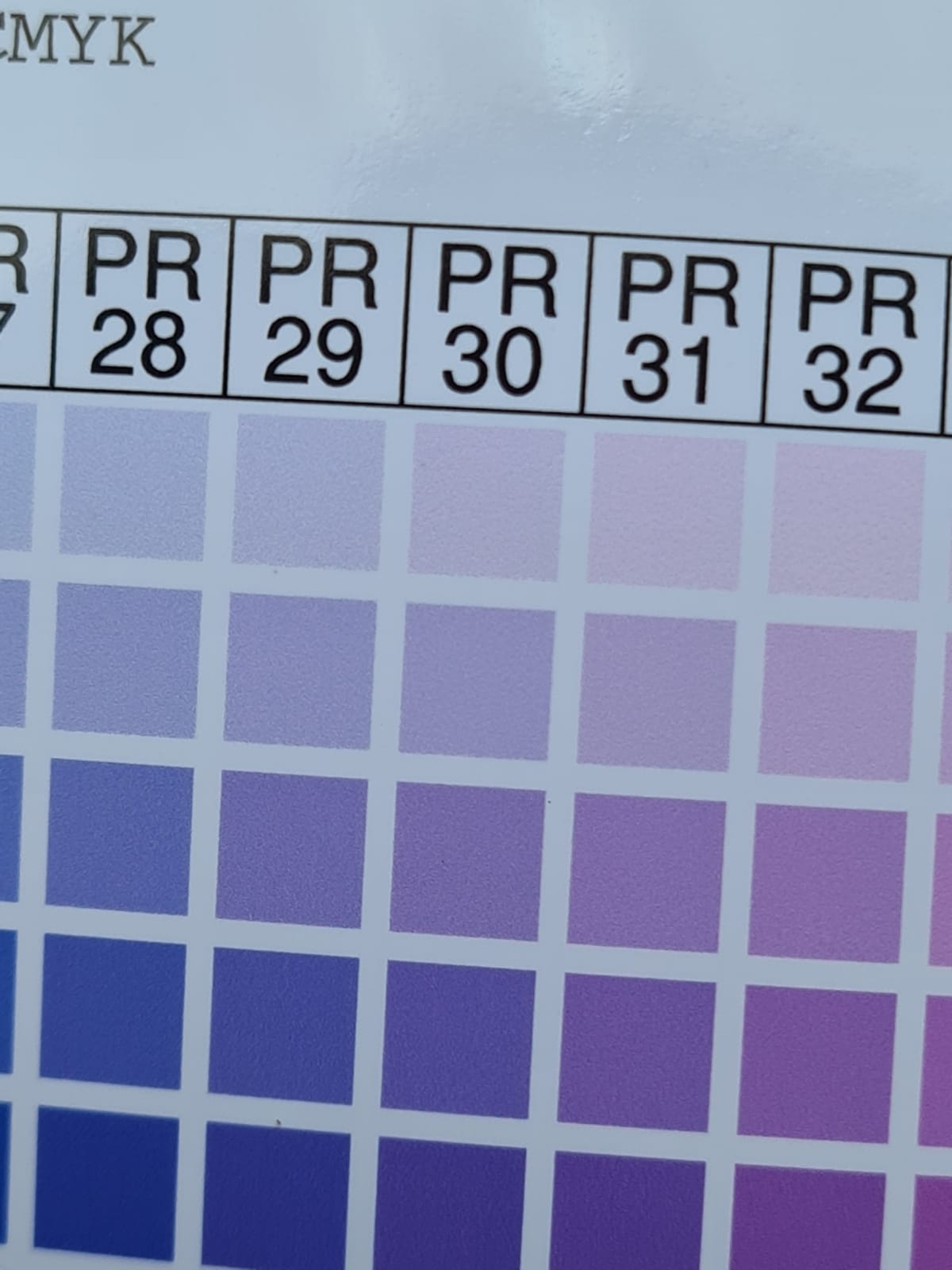

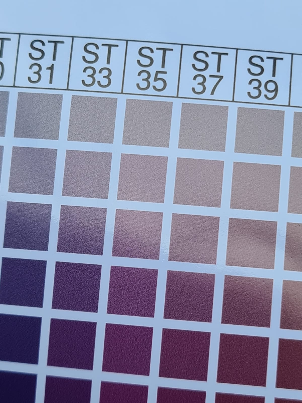

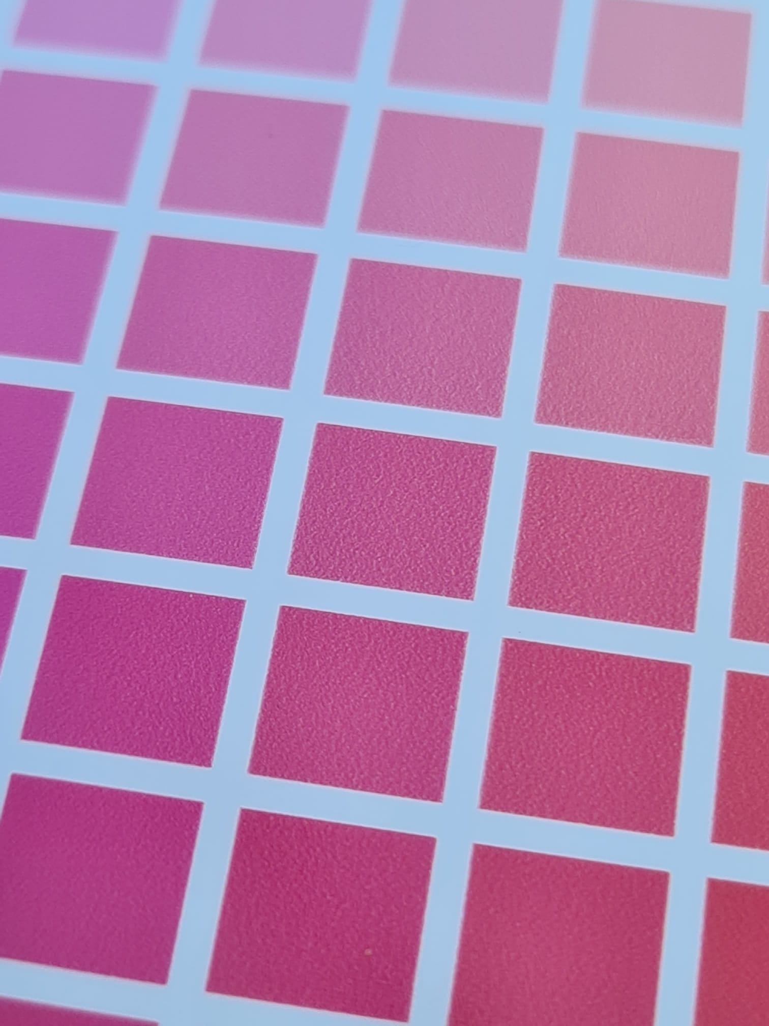

Hi

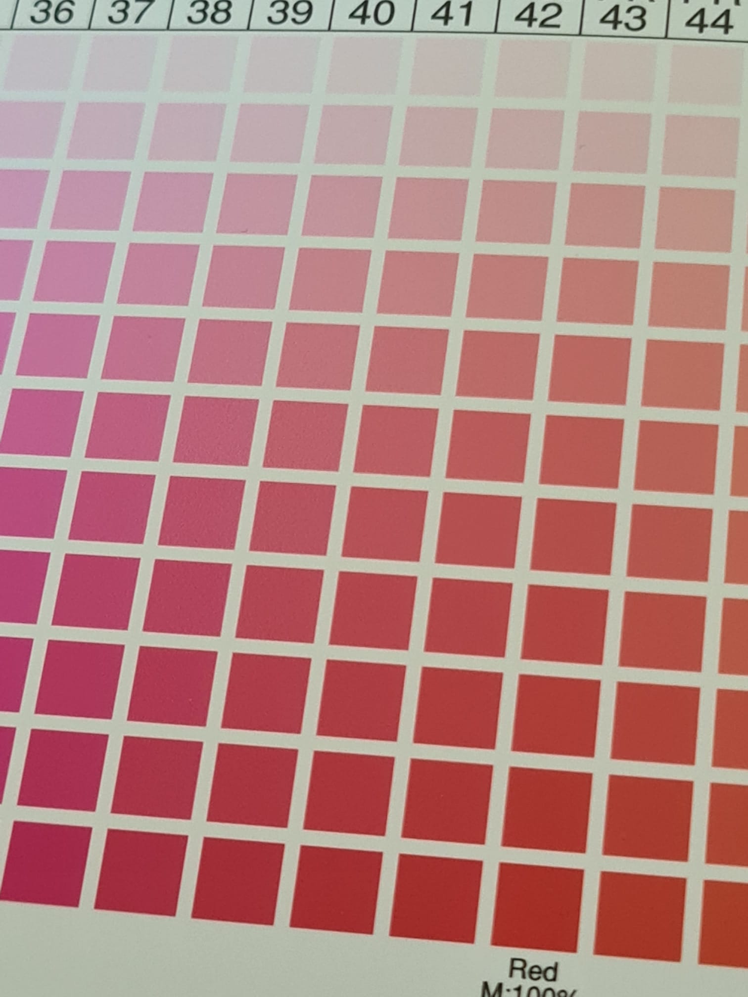

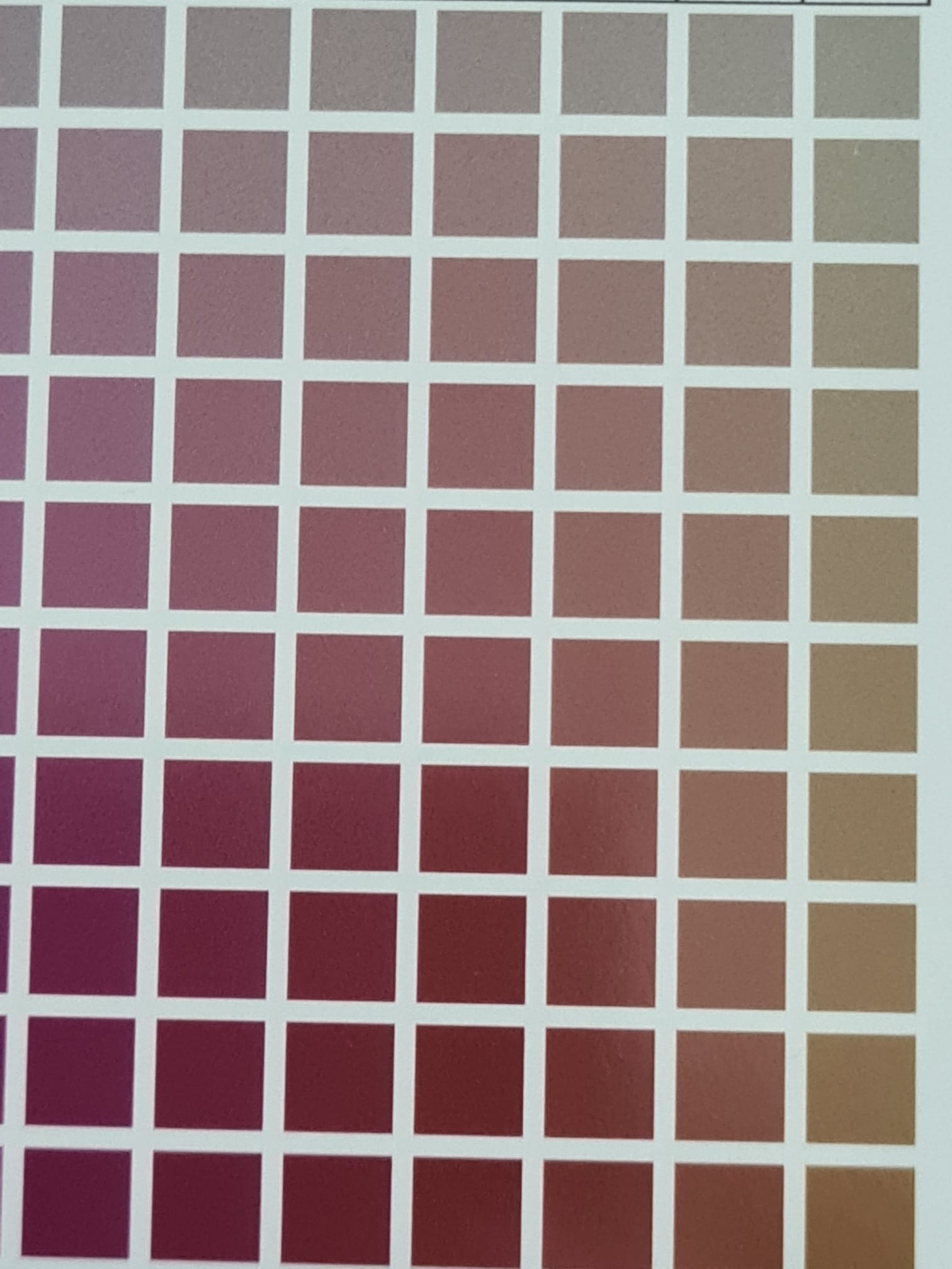

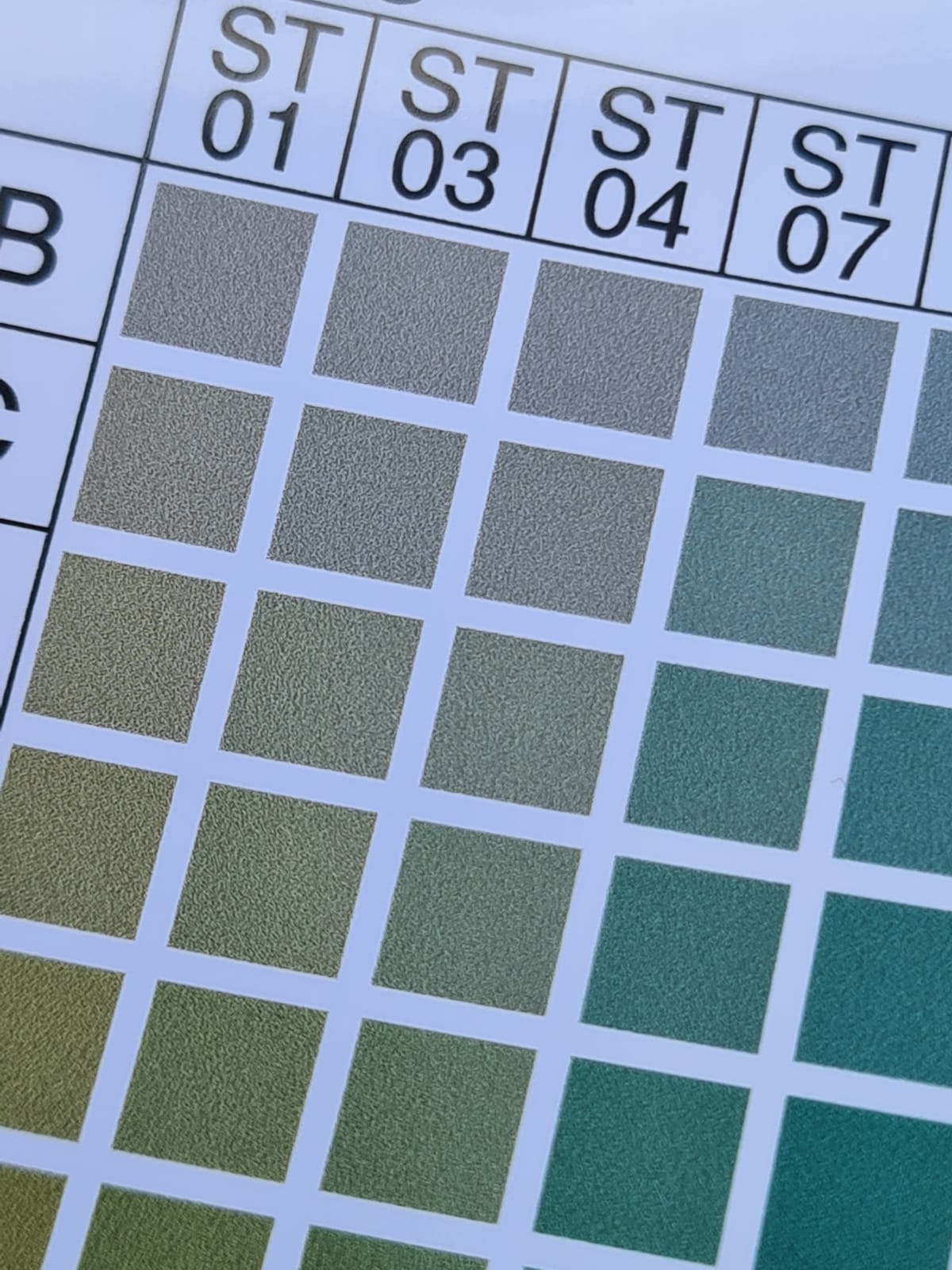

The engineer came and said the calibration is fine, adjusted heads and said its normal to get grainy even on best setting. On his print the red was alot of white dotty grain, and green.
I did a colour chart after and again same. The green especially is pretty dotty, and red. I have attached some pics.
Feedback pls

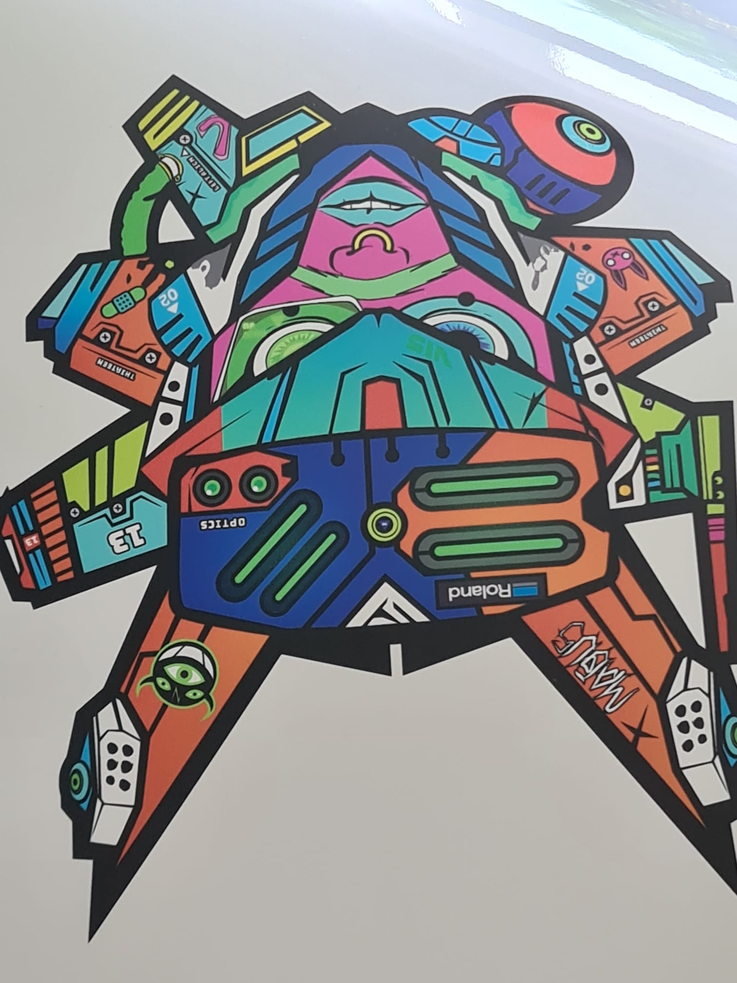

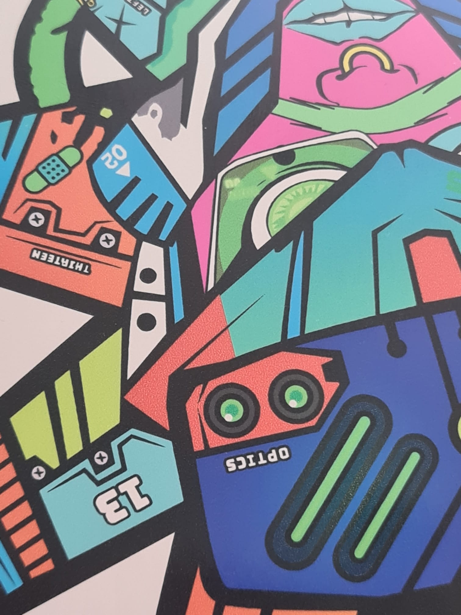

swarnes
Attached are the printed image of roland

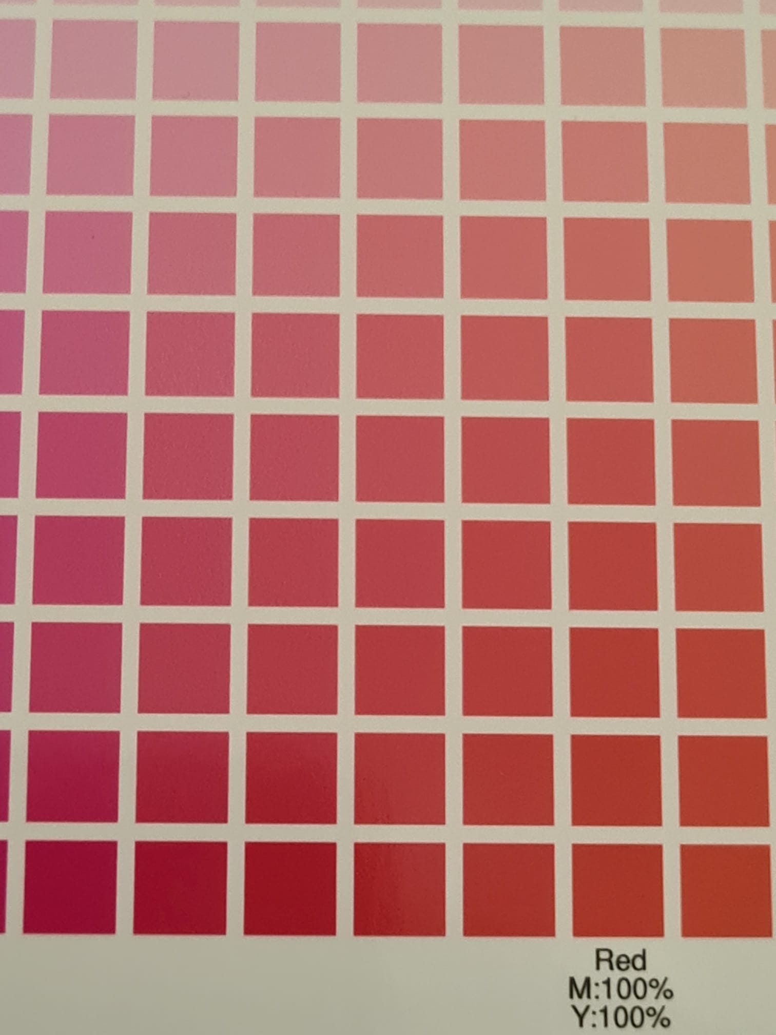

swarnes
Attached closer images of red etc

I just checked an old Roland chart we had printed a couple years ago and those "Strong" swatches definitely have some grain in them. The PR swatches are fairly solid. (Printed on XR-640)
Which profile did you use to print the swatches? If you use a high quality setting does it improve the quality/reduce the grain?

Hi,
Thanks for your responses, which profile do you recommend I try?, I have used colour density and used true colour, tried most profiles.
High quailty, uni directional, bi-cubic.
Engineer said this is normal for inkjet printer as fires dots, and not to expect any solid colours even from red, green, blue etc.
It's hard to believe this is the expected outcome slightly grain maybe, but my £200 canon printer performs better colours.

That is because your £200 canon works differently and this is LARGE format printer.
I think your pictures are acceptable. Could it be better not sure but acceptable.

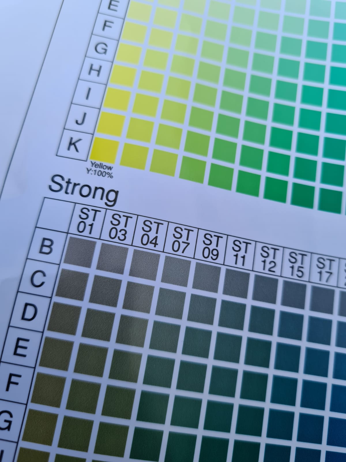

It's a little weird but your Strong colors in the first pic look very grayish.
I looked at the chart we printed off of our VP-300i and they look much more yellowish.
Did you try the "Nearest Neighbor" Interpolation? and "Max-Impact" in the Quality settings?
You might need to go for a professionally made profile for your particular material.
Not trying to muddy the matter but it does take some experimentation to get it all running smooth.

Also, Rolands are notorious for printing more grainy when print temp is too low, and worse for glossy material. Don't remember what temps I used, been a minute since I ran a Roland, but raising it till I found that sweet spot for problem media eliminated a lot of it, sometimes corrected it. Some specific materials (gloss photo was one of them), I also had to slow the head speed down, and/ or run uni-directional. Different materials have different properties, it's a learning process of what works. Also make sure your head is in the low position, if it somehow got moved to high it would be pretty obvious by over spray on the edges of prints, but on medium it'll increase grainyness or make things blurry. First time that happened to me it drove me nuts that I suddenly couldn't get a clean print, and that it was such a simple thing that I missed.
Not all media will have canned profiles, but you can experiment with ones for other materials with similar properties, generic ones... If you find something that works, in versaworks (think it's in their media explorer), you can't re-name a canned profile, but you can copy it, then you can re-name it for the media you want to use it for. In the copied version you can tweak settings and save, and if you have a spectro you can even calibrate it, and have your own custom profile.

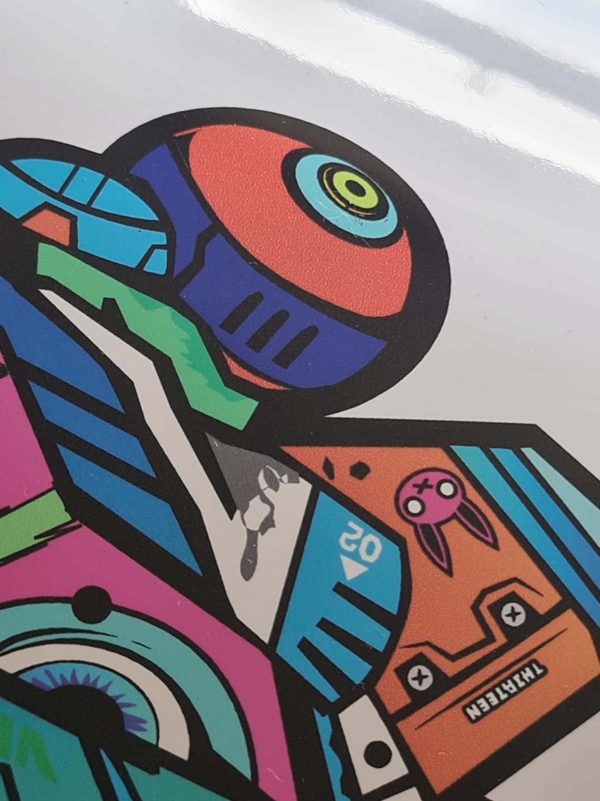

I never get grainy prints on my Roland printer. I don't think my customers would accept print of that quality to be honest.
It does make a difference what you are printing. Printing a photo image you an get away with graininess to a degree, if you are printing a logo you want solid colours.
The trick is to print in high quality and overprint x2. This uses the smaller nozzles on the head, and also lays down more ink to make a solid colour that looks the same as screen printing, rather than having dots with gaps like you get on the lower settings. Ignore other profiles and use density control only as well
