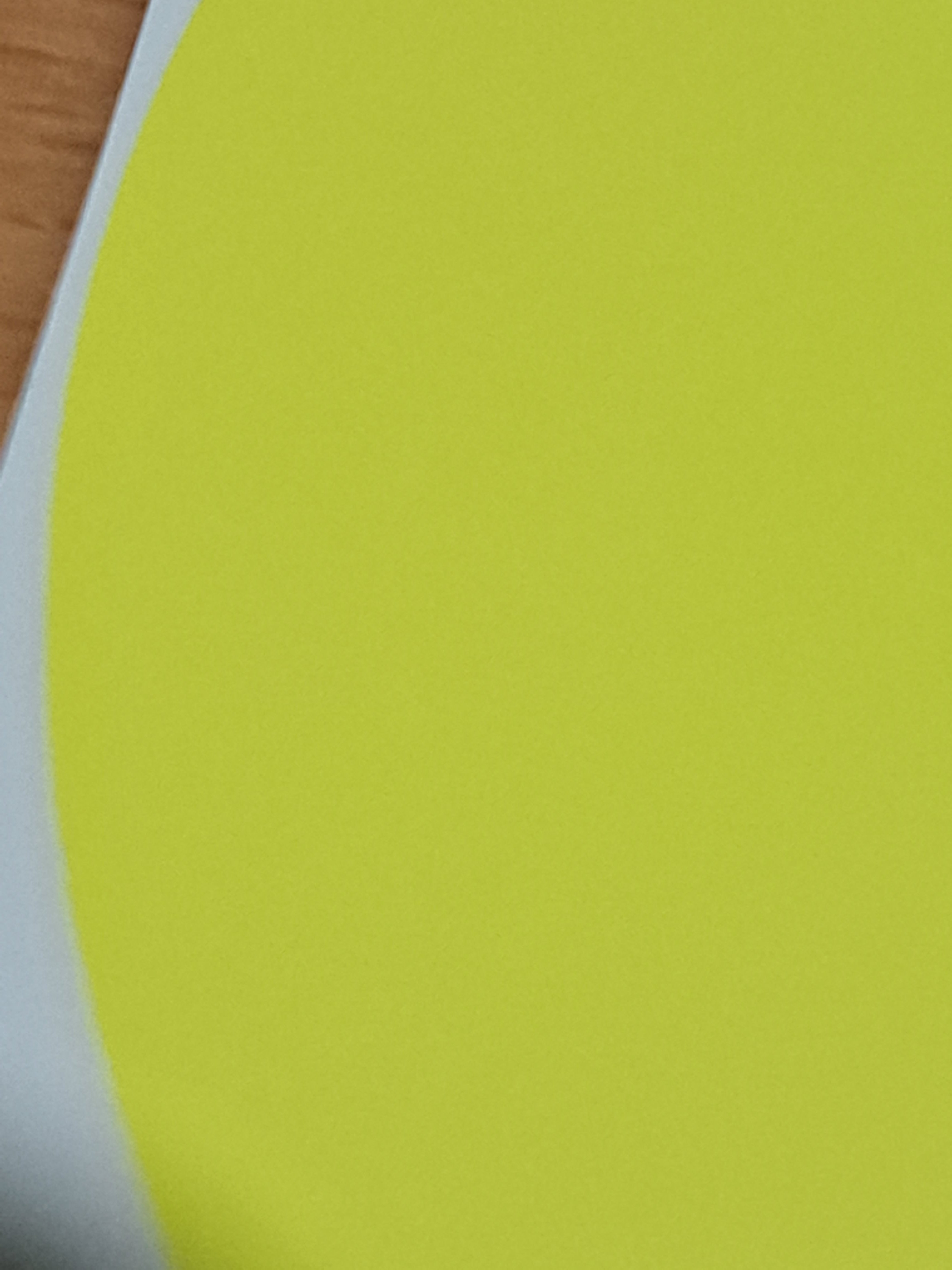

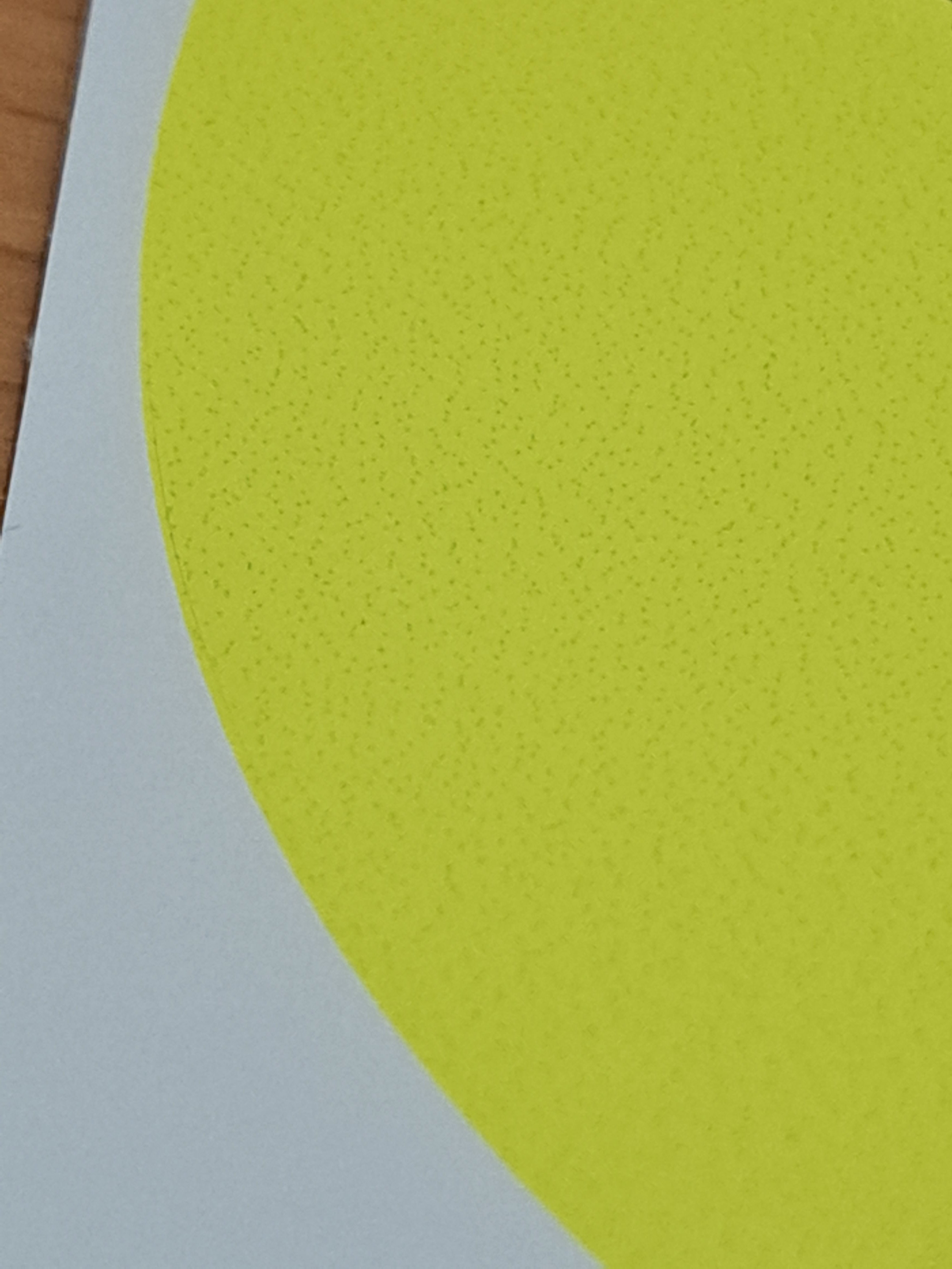

So it's still grainy on cmyk but rgb yellow is good. I have attached 2 pics is it because cmyk is not so good for vector solids? Cmyk for raster?

cornholio
Well, this is normal behaviour.
It depends on the color. You could tick "preserve primary colors" in the color management section. Then a 100% yellow will be pure yellow, while you still have correct colors otherwise.(also helps for sharper black text)
damonCA21
I always use CMYK for vector graphics, but it can depend on the individual printer. If you set your profile to density control only in CYMK this will print the colours exactly as they are on the artwork, so if your artwork has pure yellow ( 0,100,0,0 ) then the printer should print only using the yellow head and not add any extra colours in or lighten or darken it, which can cause the graininess
swarnes
Will try this, thank you for the tip!
Thanks will try this too.
Quark
Merchant Member
Some time ago we purchased a brand new epson s60 (cmyk) to replace our 8-color mimaki. I was astonished how much better, smoother, cleaner the 8 color printer prints were. Dealer sent a high level tech and the 4 color epson checked out - all is perfect, a nature of the 4 color ink set. Replaced it with 9(?) color s80 and got our expected quality levels back
I don’t think it’s in the printer or the media. It’s a nature of the 4 color ink set
swarnes
Yup, its what they kept saying it is expected from just 4 inks, I guess if you really want excellent decals you need more colour inks, shame really. Might look into getting s80 next.
