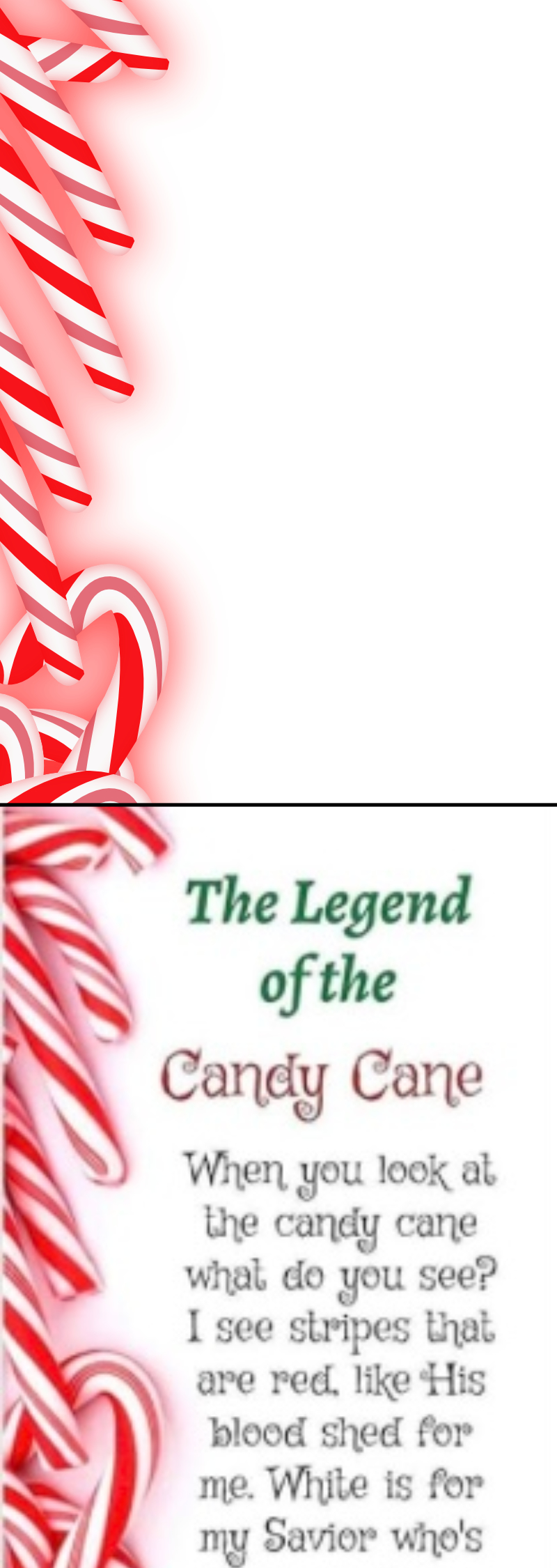

OK, so I did this (upper) in just a few minutes, so it's rough. Just draw one candy cane, keep duplicating it, and fit the pattern & how they're stacked. When you have all the candy canes laid, group them and apply an outer glow in red to the group. Add the text, and yer' golden. The canes are all the same, if you take your time and just draw one decent (unlike the quickie I did), that's the only actual drawing you need to do, and it'll be all vector.
