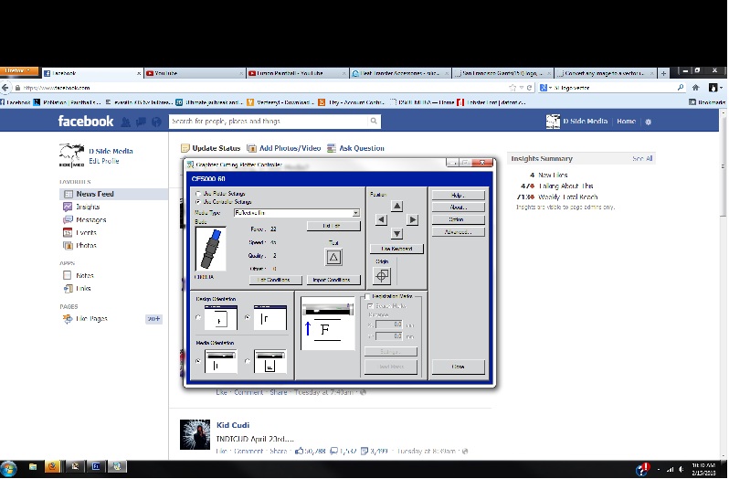

PiizzLe
Here is my settings controller. Can you guys point me out to which one you are talking about?
Thanks.
Jillbeans
The one on your machine that says "next".
I believe that is the one which pages thru the three different settings.
Just push it until Roll 1 is displayed.
