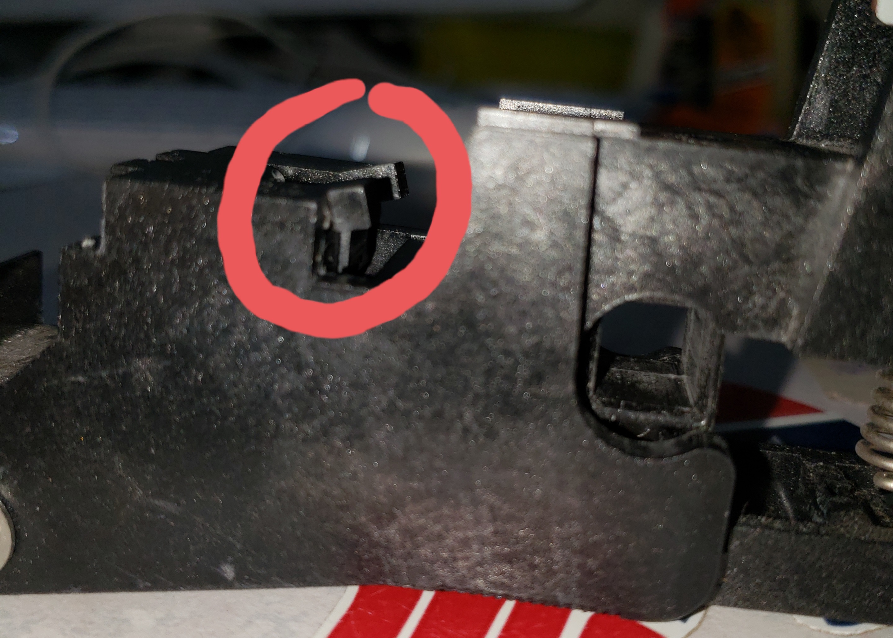

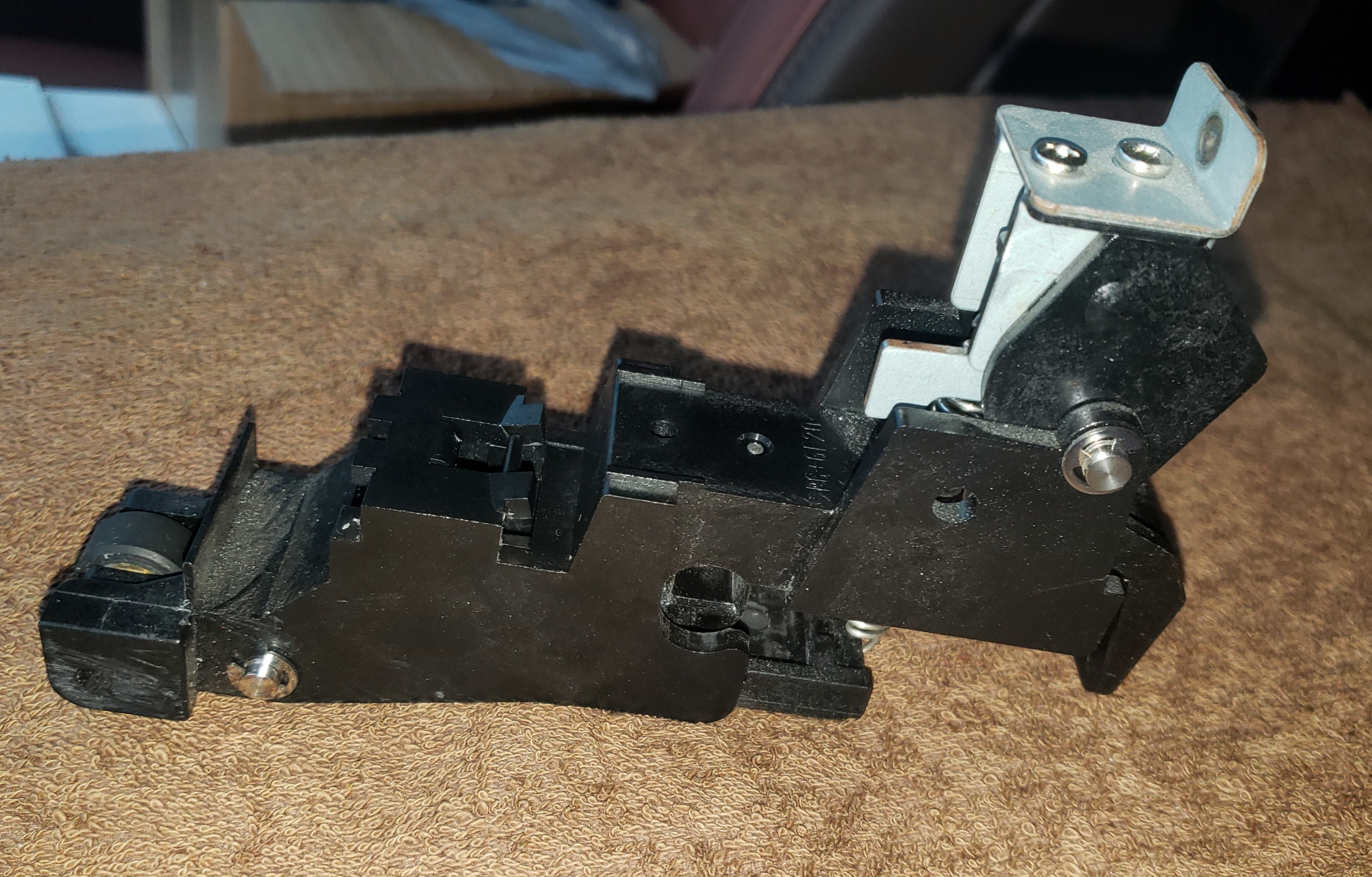

I have fixed two of them by super glueing the tabs back into place. (See broken tabs circled in photo attached)
If the tabs are completely broken off you need to buy a new one, but dont throw the broken one away as I am working on a prototype to fix them. Ill post pictures soon to this thread.
Forgot to add:
Be a little sloppy with the super glue then sprinkle with Baking Soda powder it will help to add body to the sides of the repair. After glue is hardened use a percision file to smooth the inside surface only of the tabs so they will slide back onto the rail. The glue and baking soda powder will add strength to the sides of tabs.

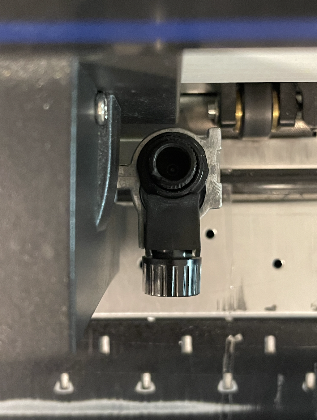

Don't forget that the knife has two positions. One for cutting perferations and regular cutting. I often forgot to move it back and would inevitably mess up the next job. So I started moving it back as soon as it was done.
Bill DiStasio
If you get tired if moving it back and forth, I have a little invention I made to avoided taking it completely out and messing up the threads.
Joseph44708
I Drink And I Know Things
I always leave my blade in the front position, (channel cut) I have never cut on the cutting strip.. No matter what I'm cutting. Kiss cut, Perf cut or straight thru cut.
It's all in the set up of your Graftec cutter.
I cut today what I printed yesterday from Two Seiko W-64 and Two Roland XR-640 printers My three Graftec cutters are the 8600 -130 and 160 and a 9000-140 they all run the same way all day.
300' to 400' of 54" vinyl and they never miss a beat.
