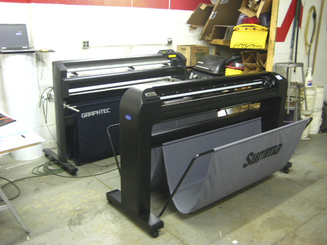

we had a tech come out and replace the sensor, even he could not get the machine to find the crop marks. Yes we put the print in straight you can watch that using the white lines on the cutter as the vinyl move back and forth. Yes we tried all the graphtec bandaids, scotch tape, sanding the crop marks, turning off the lights, re-drawing the marks with a ball point pen nothing worked consistently. Sometimes it would find the marks though, and that is what was so fusterating about it.
So maybe we just got a bad one but I can tell you this is a real side by side comparison, Believe me we didn't want to have to go buy another cutter after we just bought a brand new one.

Graphtec's ARMS should and does function similarly. Ironically, only the newer Summa OPOS X uses the white-light sensors that Graphtec used from the beginning. The earlier red light sensors Summa used were fine with their thermal transfer printers (no lamination) but for inkjet they were problematic since they didn't read well through lamination.
And it's pretty simple deal really: If the sensor is calibrated and the sensitivity is properly adjusted, bingo, they work beautifully. The only other potential problems are media loaded poorly (skewed too much) and on some longer jobs, calibrating the X-axis tracking when dealing with thicker media combinations that cause tracking to be longer ... in the same way the outside lane on a running track is longer.
So frankly, I'm surprised you had a problem that was not easily sleuthed -- and fixed. If the basics do not solve it quickly, it's usually a bad sensor, which happens on rare occasion, with every cutter. That's all I can think might have been an issue.

We had a similar experience as LittleSnakey in the past. Went through two FC5100s and an FC8000 and had a nightmare of a time getting it to read registration marks. Technicians were not able to fix it either. The only times we were really successful was when we turned the lights in the room out and put a cardboard "hood" over it. We eventually got sick of that and sent them back and got a Summa S160. 5 years later it's never, ever ever missed a mark and it's still going strong.
Since you're looking at plotters do yourself a favor and check Summa out, it can't hurt anything.

Hmmmm. Something is amiss. Obviously they do work, or Graphtec would be the target of a class action.
So it has a flaw somewhere, perhaps on the mainboard. But whoever sold you the Graphtec should have swapped it out for a working one. Maybe they still can. How long ago did you purchase it?

all of your problems with the reg marks are becuase they send out the machines with a arms intensity setting of 70 & 90. STUPID on their part.
turn them both to 70 and it will read fine.
the 90 setting is so intense its scattering the laser and making the machine think its reading something that its not.
how do i know this?
the $5000 carcass of a fc 8000-130 that i put through the wall is sitting on my floor as a constant reminder.
sadly their tech support has no idea about this issue nor how to fix it.
even though I SPENT WEEKS going over it with them and denco.
denco would show up and cut unlaminated media on it and say "oh its fine, see!!!!'
yeah. i DONT CUT UNLAMINATED MEDIA.
so when the lam went on, it messed up the laser. they too had no clue. they wanted me to switch my workflow blaming it on GRAPHTECS cutting program. sheesh. WRONG.
so yeah in the end, i had to figure it out on my own.
give it a try. it works. and it works perfect.
