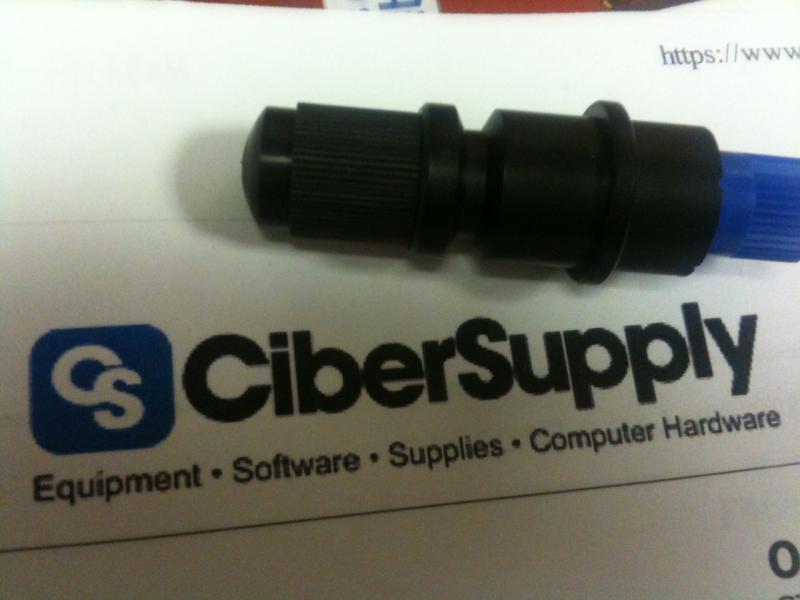

CB09U blade
plunger is the one with the blue cap
PHP32-CB09N-HS according to user manual
Installed the blade from the video at graphtec website.
CS-SignSupply
Blade tip exposed should match the thickness of the vinyl you are cutting.
The blade offset should be '0' if it is 45 degree OEM blade with the CB09u (blue tip holder).
