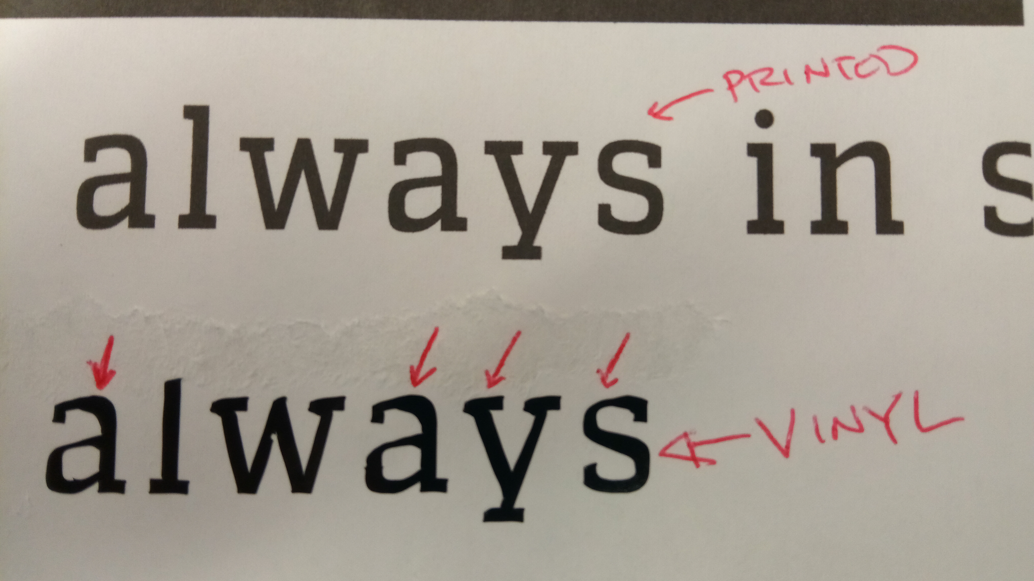

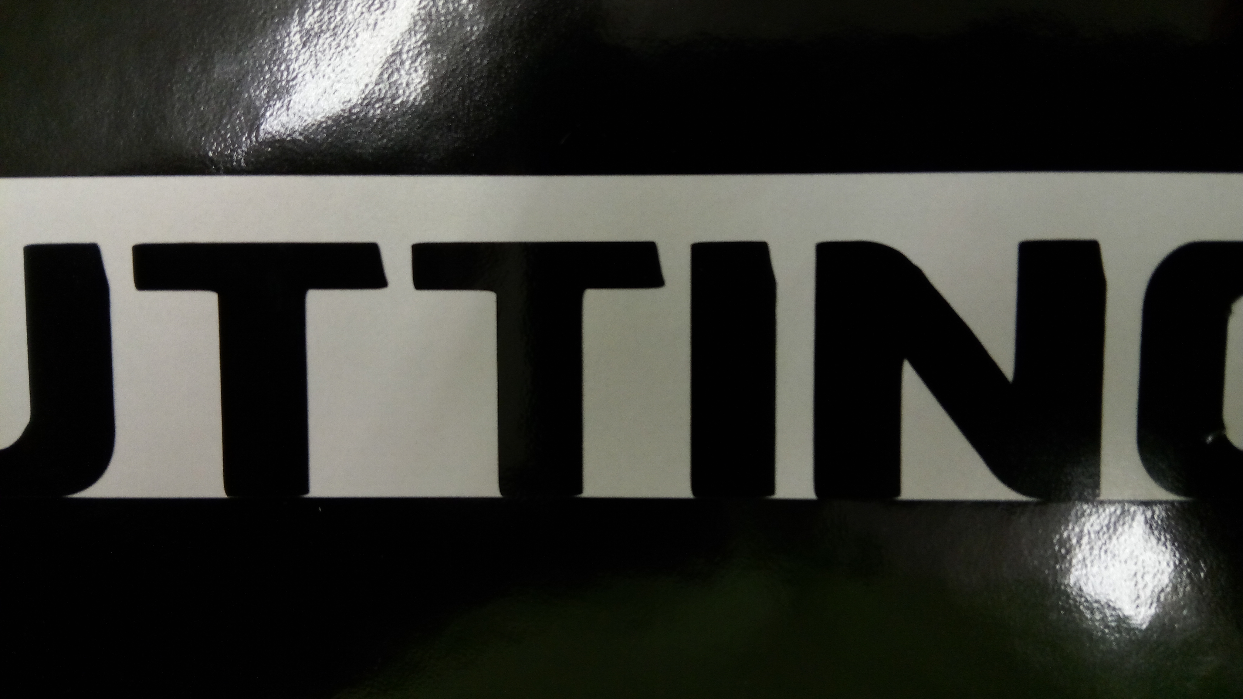

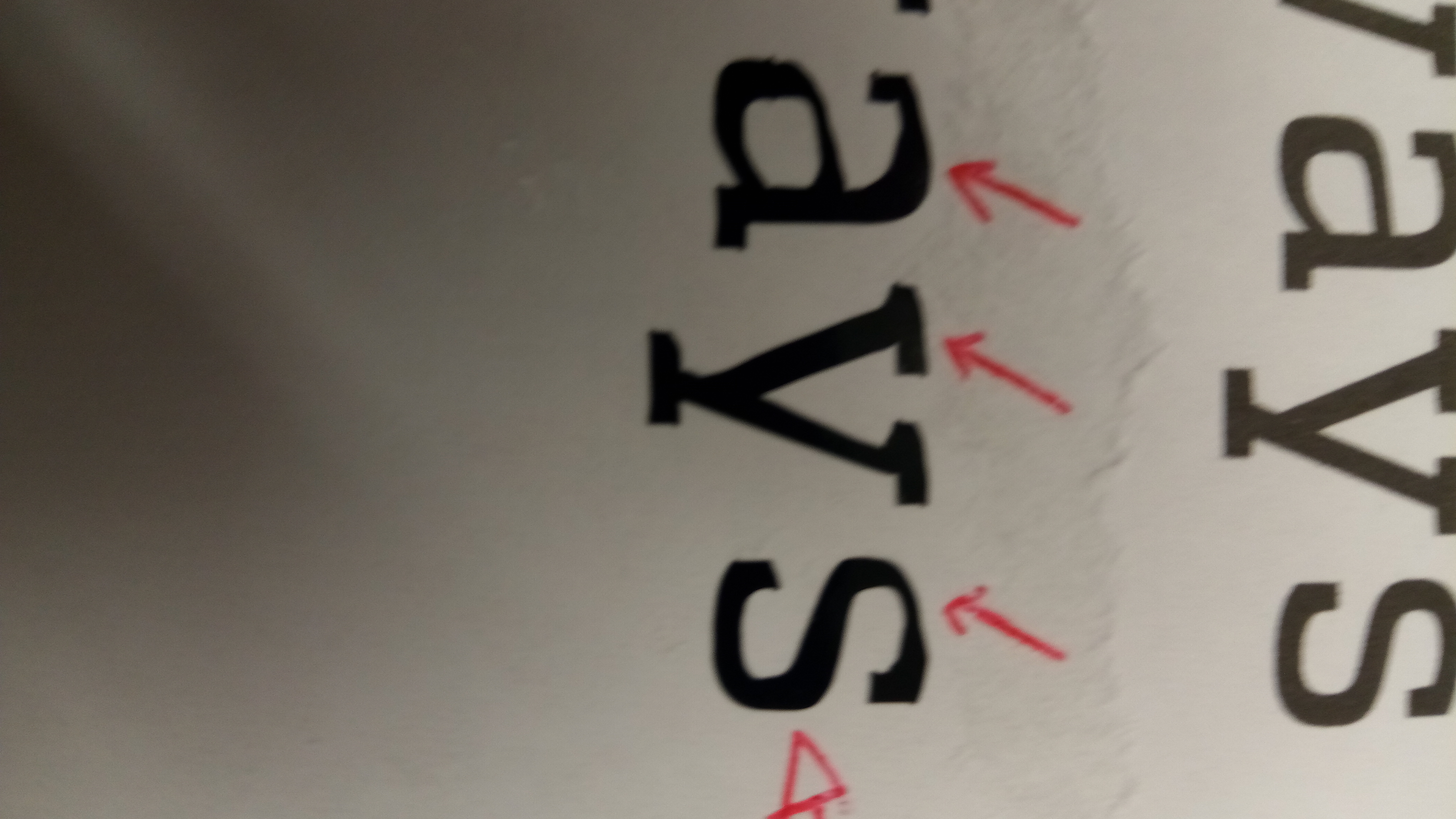

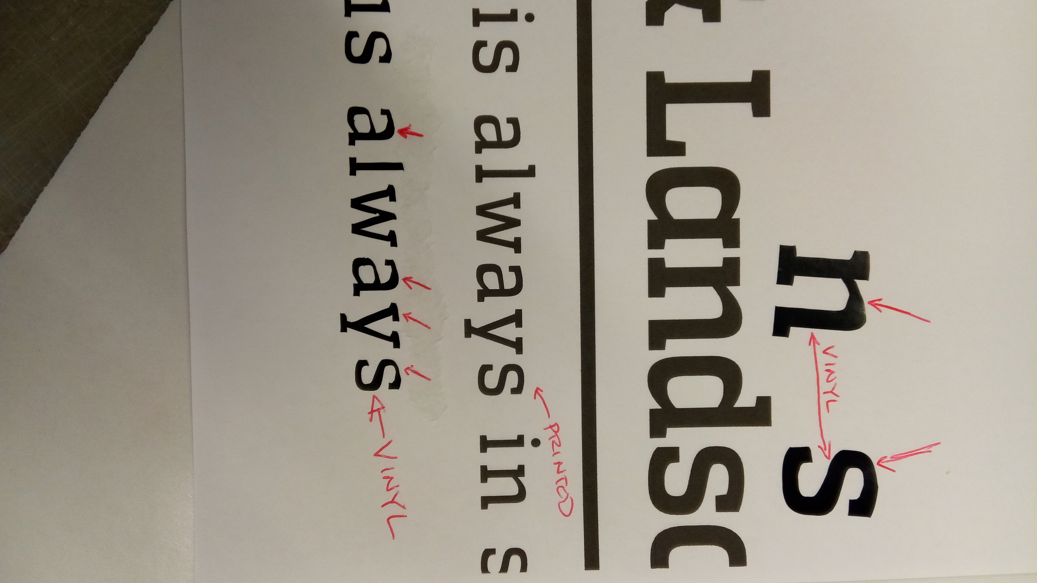

Our Graphtec FC-8600 plotter has started acting weird. Cutting lettering around 1", which has never been a problem, has started giving us bad results. It's almost like there are plotted points being skipped. The type of vinyl or the condition choice doesn't matter. Also, no matter what we do I can't get the offset correct. The pictures should show it better. The cutting head isn't loose, the belt is tight, and there's no wobble in the blade holders.
What we've tried:
•moving the cut to opposite end of the plotter so that if there was damage to the cutting strip the cut would avoid it.
•Replacing the blade
•Replacing the blade holder
•Changing down force, speed, offset
Graphtec support is working on it but we're not getting anywhere. We've got a new cutting strip coming in but I'm hoping someone else has had this problem and might have a solution. I've got work backing up waiting on simple little vinyl pieces to finish.

I think we've found the problem. There is the slightest amount of movement in the cutting head. I didn't think it was abnormal and from my description the Graphtec tech didn't think it was either. If I do something brilliant like holding the moving cutting head firmly against the rail while it's doing its job the thing cuts beautifully.

PROBLEM SOLVED: Figured I'd post this in case someone looks for an answer later. We ended up taking off the head cover and the cap over the carriage rail to give us access to the roller wheels on top of the head. Loosen those, hold the head up, tighten the screws back....problem solved. Took two days to figure out what the problem was and how to fix it....the actual repair took five minutes.
