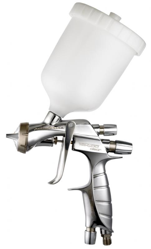

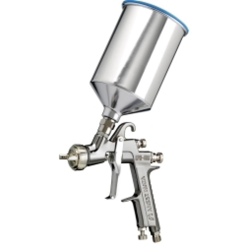

Atomic DNA
These are the guns we use:
The LPH 400 for clear
SuperNova with gold cap (1.3) for base
We also use the 3M PPS system.
