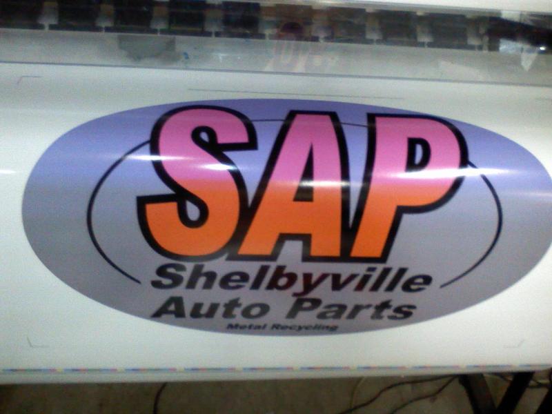

Printing a logo, the first time I stepped out and it printed totally wrong, so I did a nozzle check and everything looked good, so I did a reprint, and it started out good, then the last 25% turned back to the purple/pink instead of gray orange. Anyone have any ideas? Mutoh Falcon Jr...not getting a low ink error or anything...not sure what to do! Will post some pics after I run some errands...

Here is the photo...

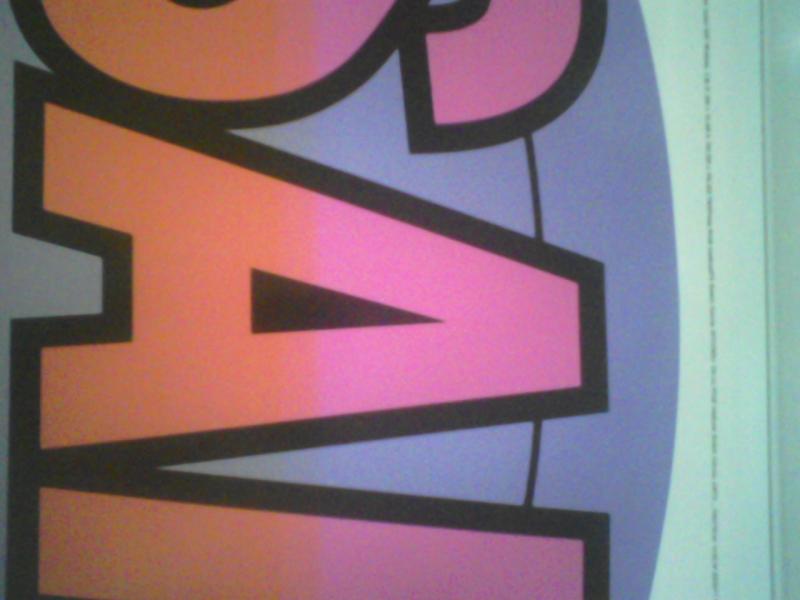

close up....and as I mentioned, the first run on this, it printed the whole logo which is 13"x21" in the pink/purple, then I made sure my color settings had not changed and started a reprint, and it did this...2/3 good...The Nozzel check looked good, all colors look to be firing like they should. Kinda stumped on this! It has printed fine up untill today, and I have a crap load to get done!
randya
This looks like nozzle dropout.
Typically dampers, with not enough ink flow to the head fast enough.
This usually clears up enough to do a nozzle check, but will drop out on longer prints.
Did you replace dampers 6 months ago as well?

Looks like Dampers. Probably getting plugged. And particularly the Yellow. That's what running out when the orange turns to magenta.
Knep
Did not replace dampers then, I replaced everything but them, capping station, pump, lines, heads...and I did replace the black damper about 2 months ago, looks like I need to make a phone call and get some dampers ordered...Using Flexi 8.1 pro...
