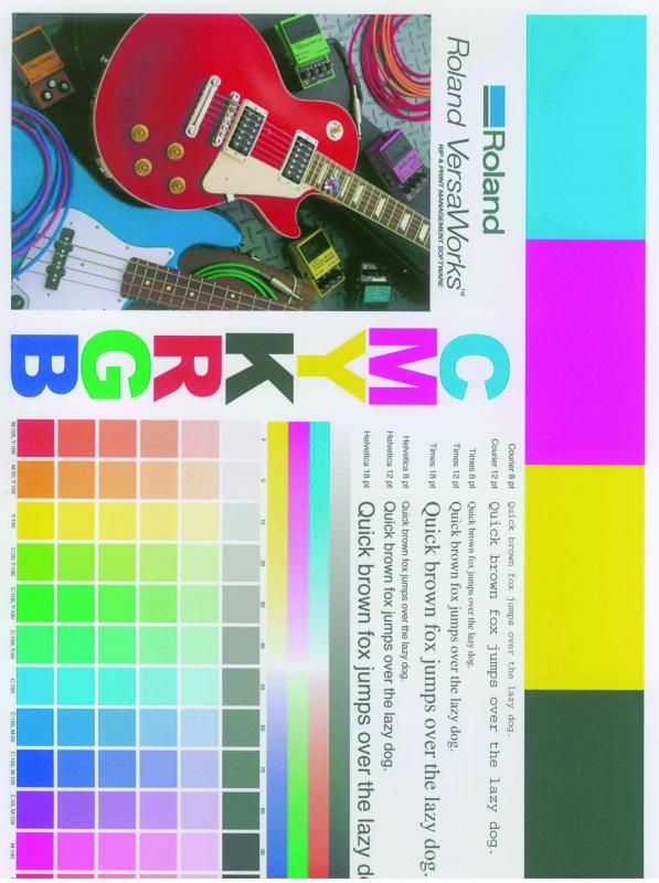

Hey guys, we just got a new VS-540 to go with our XC. The tech came and did the "setup" last week on it. I wasn't there when it was done so I didn't see the condition it was left in when done as far as print quality but it less than good. The black is printing out very green despite media or profiles. Even when doing the CMYK test print out of Versaworks it still has a very green tinge to it.
I tried 100% black and my usual 30/30/30/100 that gets me great blacks on the XC but still getting green on the VS. Even using the free roland media that comes with it and their specific profile the colors are way off. My next issue is the black is not coming through properly either. When you look at the print it looks splotchy (sorry, don't really have a technical term to describe it) almost as if there was cleaning fluid or something mixing with the ink. On the Versaworks test print you notice in on all of the blacks and any of the darker colors where the black is being added in. It almost seems as if the black head wasn't pumped up and filled properly. This is unacceptable to send out the door to our customers and I'm not willing to settle for this on a new printer.
Sorry for the long post but I wanted to describe it accurately. Any of the guru's on here have any recommendation as to where to start or what to try to get this working properly??

No the nozzle print (actual machine test print) is fine with no dropped lines. This is the versaworks test print I'm doing. It's the one with the guitars and the cmyk blocks on the side. I will go do one and post it up here. The issue with the tech is I am less than confident about his abilities. If I can fix this myself without doing anything major I would like to. If it's gonna require yanking apart heads or anything major I will get him back here.

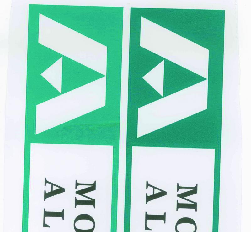

It does it on all medias with every profile I've tried including roland media with their profiles. Here are 2 scans of what I'm talking about. You'll see how washed out looking the black is and if you look in the black and the darker colors like red, blue, etc. you'll see the splotchiness I was talking about. Especially on the teal of the 2nd image.
The attached images aren't really big enough to see it so here are the photobucket links. Thanks guys!

How are you getting black behind the guitar and various areas on the picture, but not in the black boxes ??
Somehow, you are capable of achieving black, but not through normal channels. This is different.

I went back through Versaworks and set it to Max Impact and now the blacks are better so the color issue isn't really a concern any more. The blotting ink is still an issue however. Like what you see in the teal in the 2nd picture. Any thoughts on that?

That's a weird looking black. Try it on US prepress? Also, what is the setup? is it cmyk or double cmyk or cmyk+w+mt?
Custom_Grafx
re the blotting, try the 16 pass profile - head speed on 500, full width scan, put your individual ink limits on 75% across the board for starters, and total ink on 180-200%.
