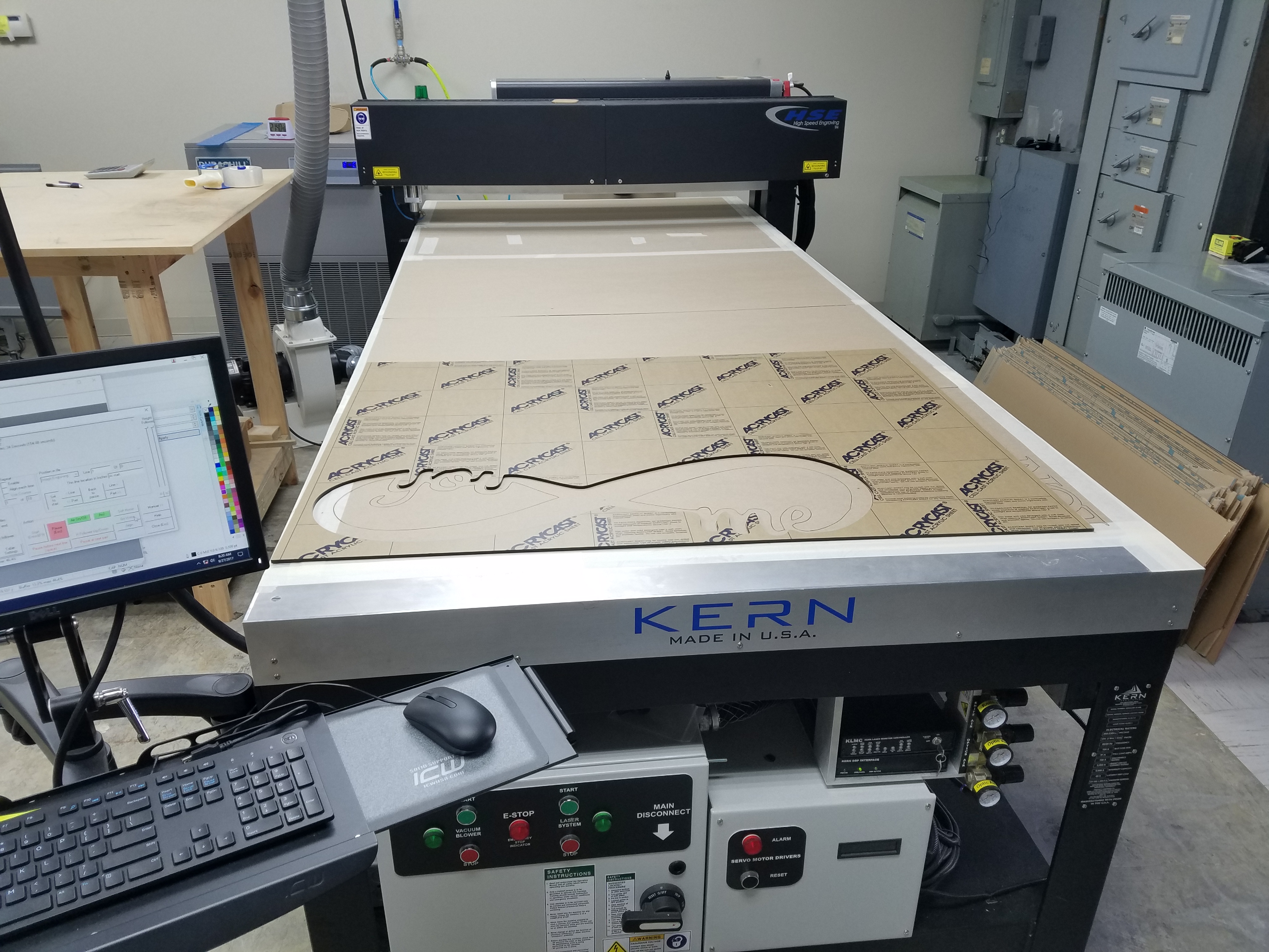

I'm interested in how thick the chipboard is that you glue on the honeycomb and does it smoke when cutting? I've never heard of doing this. Can you elaborate more ?

Glad I could help. It is about .030" thick chipboard. I get them from my supplier at 24"x48" pieces. See picture. It does not smoke at all and prevents flashback from the honeycomb onto the acrylic. Acrylic is my main product here....I also use the Kern .75" standoffs when cutting 1/2" thick and above. I remove the chipboard from beneath the cutout when doing this like in this video.
