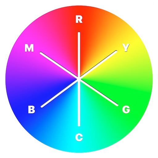

ColorCrest
All around shop helper.
Find wherever your color curve is and tell it to reduce the total amount of cyan and or boost your magenta if your grey is looking a little bluish
If cyan is reduced from a blue-tinted gray, the blue hue will shift by taking on magenta, appearing more purple. If magenta is boosted, yet again, the blue hue will appear more purple.
Color correction of a blue-tinted gray would require more yellow which is the opposite of blue, or a reduction in equal amounts of magenta and cyan which the color blue is made of.
Humble PM
If I'm lucky, one day I'll be a Eudyptula minor
I spend 3% of my working life helping folks printing in colour darkrooms. Jumping from RGB to CMY thought processes - reminds me of a day, decades ago while doing C&G747 in the darkroom printing both colour negs *and* transparencies.
Easy to slip into the wrong correction.
