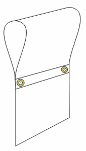

I can add the grommets in house but I'm not sure where to put them...
I've been searching around online and on here but haven't seen any specifics.
I'm a little confused because some of what I see makes it seem (no pun intended lol) like the grommets help reinforce the hem, while other things make it seem like the grommet is just for attaching the banner to the hardware.
Do you put the grommets directly through the sewn seams or just below the seam/pocket?

If the banners are made correctly they'll be double sewn through the loop and down the edges. Then, below the stitching is fine, as the stitching will help it from tearing out. If the edges are not sewn, I'd suggest putting in on the sewn loop stitching. Otherwise, if there's nothing to help hold it together, strong winds can easily pull them out.
