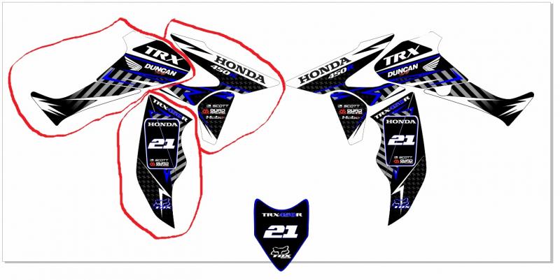

As the picture shows I'm trying to group the red selections so I can rotate them / move them around so I can use the least amount of space when I print it .
I can't figure out how to do this as there is probably 10 layers for each section .
If anyone could help it would be great .
Thanks

first move the little piece in the center out of the way
then hold the control button down as you use the selection window to capture the selection in red
the control button will only grab what you completely surround with your selection window
might as well group them when they are selected so it makes it easier if you need to move them again

I searched for a solution for this issue and found some threads in a corel forum that showed how to do it with the color docker.
I didn't bookmark it and I don't remember how it worked, but if you search there is a way.

Hold the "Alt" key and drag(left click & hold) across just what you want selected. This makes it temporarily act like the extremely irritating border crossing Illustrator selection tool.
Shift + Alt will allow you to add to the selection without picking up unwanted bits.

to add or subtract anything from a group hold down on the shift button and click on object, to group control+g, to ungroup control+u
