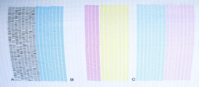

OK, I see there are some issues with the black head. Fine... But what the heck is going on with the Magenta Head? It's the newest head in the machine.

vapor lock. pull a very very gentle vacuum from beneath the cap (either the drain line or separate the union going to the pump.)
