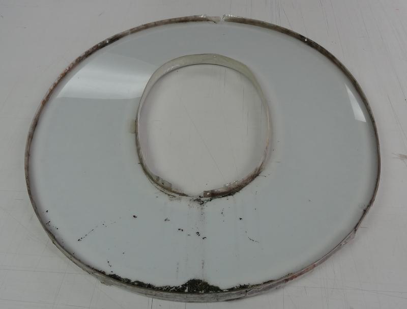

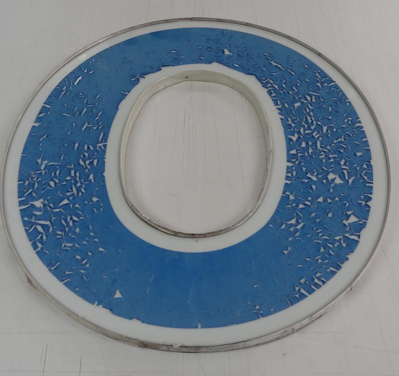

Looking for a source that carries the attached type of Halo-lit channel letter faces.
Thank you

Just helping with the verbiage:
Those faces are off "front-lit" or "internally illuminated" channel letters.
"Back-lit" channel letters have acrylic/polycarbonate backs and are typically referred to as "halo-lit", "reverse-lit" or "back-lit".
If the faces and backs are acrylic/polycarbonate, they're typically referred to as "dual-lit" channel letters.
If you get rubbings of the letters, any electrical (and some non-electrical) sign shop can make those.
J Hill Designs
its just acrylic with trimcap material. easy to make your self. 'pop' the old trimcap off, use the existing letter as a template, cut new acrylic, decorate, then put new trimcap on (using weldon thin first, and then a bead of thick)

Thank you for the proper terms, and now to try and remember the differences

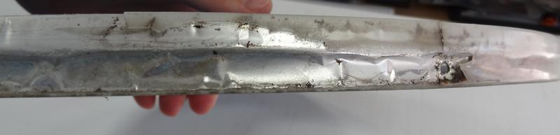

the trim cap is what is throwing us, you are correct the letters and vinyl are easy to produce
J Hill Designs
the trim cap is what is throwing us, letters and vinyl are easy to produce
well, an o would be just about the easiest letter to practice with. work off of the roll of trimcap (ie dont try to cut to size)
As you set it along the acrylic, making sure that the acrylic stays inside the 'foot' of the trimcap, use nails to hold it in place (some places use steel tables and heavy duty magnets)
once its all held together, use thin weldon along the seam. let it sit for an hour or so, and then apply a bead of the thick weldon
edit: this is all done 'upside down' ie not on the face

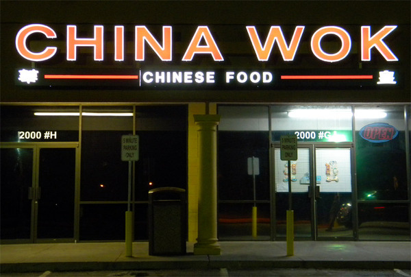

I believe what he means is, with the 1/2" white all around the trim areas, at night from a distance, it will create a halo effect all on it's own.
It would have this kinda effect on ya.
Not a true halo as we now know it, but something similar.

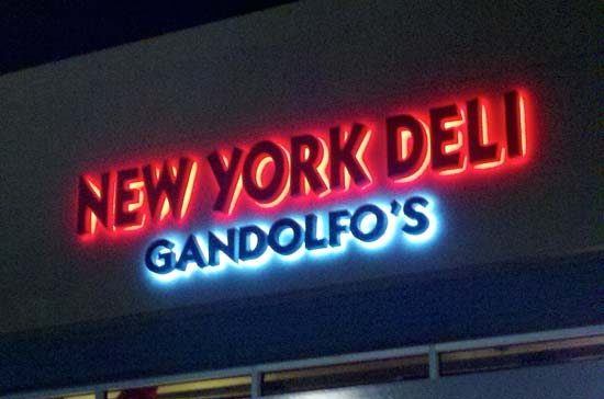

why did you change the title to halo-lit? what you show is a regular channel letter face
I'm assuming because Moze pointed out this is a Halo-Lit and changed it to reflect the terminology.
to the OP, how old are those letters and what direction does that face?
J Hill Designs
to the OP (and txfb....): this is what halo lit letters look like

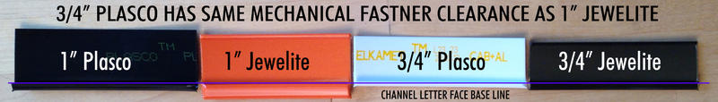

edit: @kgirl you may be saving a bit of money with 3/4" trimcap, but you are lowering the lifespan of your letters - way more susceptible to breakage during service.

kgirl
I'm sorry you get breakage and lower life span using Plasco trim why?
kgirl
Ohhh....you misunderstood.....the mechanical clearance of 3/4" Plasco is the same as 1" jewelite....so if the intent to use 1" jewelite is for more surface area you can do the same with 3/4" Plasco. At the same time you will spend less and it is easier to work with on small letters....
