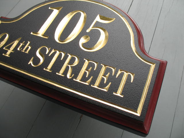

The Moore Glo is a bit thicker......doesn't flow as well as the Aura.
I use a fine roller to paint the faces and with the Glo, I can raise a fine stipple. I call it my "bright texture" finish......sorta reminds one of smalts. The Aura flows better so it 's tough to get the same stipple effect.
So, two coats of Glo to get the stipple and one coat of Aura to get the better adheason properties......it's also marketed as having a "color lock" technology.......whatever that means. It is just another sales point.
If you try it, you have to make sure the Glo cures.....at least 24hrs. They have different bases and can't be mixed.

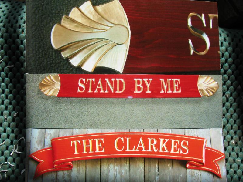

This ribbon is different.......it was painted with a foam brush.......2 coats of Aura for a smoother, semi-gloss finish.
Here's a pic where you can see the stipple.....when the light is right.
It's just me being a little different than the rest......that traight has served me very well for over 33 years.

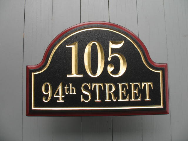

Here's a pic of the same ribbon done in pine......about the same size.
The quarterboard shown with it has, what is called, a feather end.
