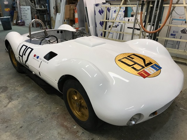

I've done a few, mostly stock cars, reproducing the original from old photos. Those are usually not too difficult because the quality of lettering wasn't always professional
But this one was a real challenge, engine turn gold leaf meatball with lettering on top of it and it had to be done in a week to get to one of the biggest national shows.

That's awesome! Until recently I didn't even know engine turn was ever hand painted. It seems like one of the more difficult things to paint!
Billct2
Gold leaf is a bit tricky and engine turning adds to the fun. I use a piece of velvet on a padded dowel and spin by hand. Some do it with a drill but I'd be worried I'd burn thru it.
The worst issue with this one was not having time to clear the gold before I lettered on top of it, there is no fixing an error on gold leaf.
