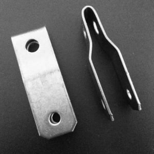

View attachment 132741 Try these.
Harbor Sales
SHA2075SS
Those look custom.
Those are for 1/2" thick material like PVC or MDO. If he took two pieces of 1/4" Sintra/PVC cut the same size as the interior of that style clip, he could sandwich the .060 Aluminum between them, through bolt the whole works and be done. Those are clips are around $7.00 each at HooksandLattice.com
I don't trust pvc for outdoor use--it gets brittle when temps get extremely cold. We've use the Harbor brackets and simply use a vise or hammer to narrow the opening to accept ACM or 3mm Sintra. We've also used them to hold 040 aluminum in L frames for realtors, but the wind whipping the signs around causes aluminum that thin to tear along the bottom of the bracket.

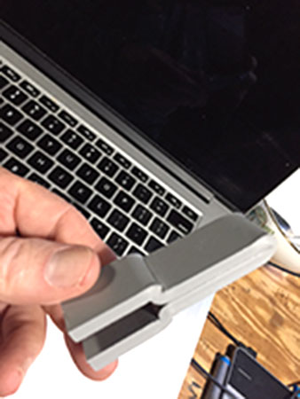

You said you wanted to upgrade him, so why not give him 10mm ACM and get it already in black and apply the rest of the vinyl as needed. If you cannot fabricate custom brackets on your own, like Johnny Best pictured, they won't cost much to have made for something which looks better than those wood holders.
