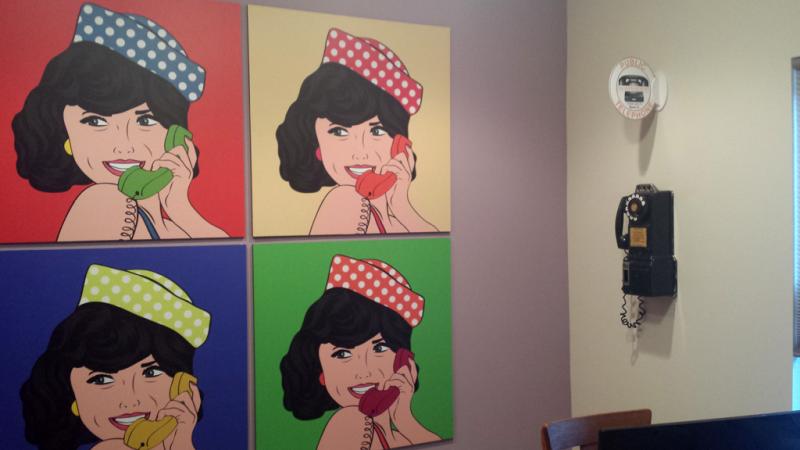

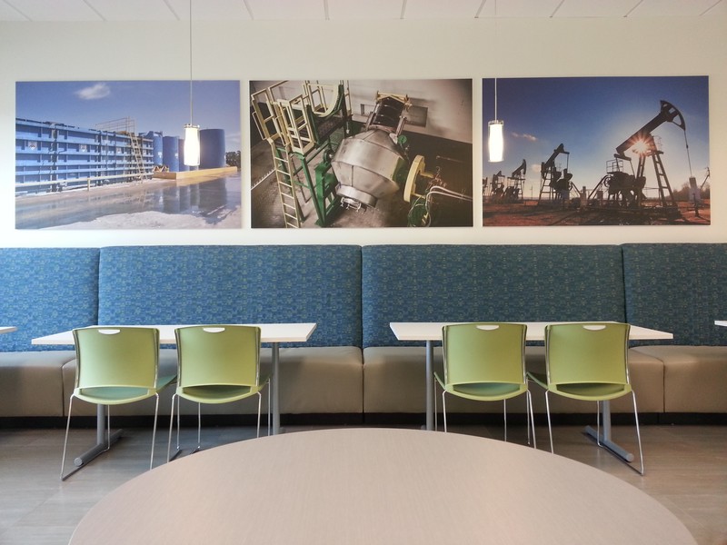

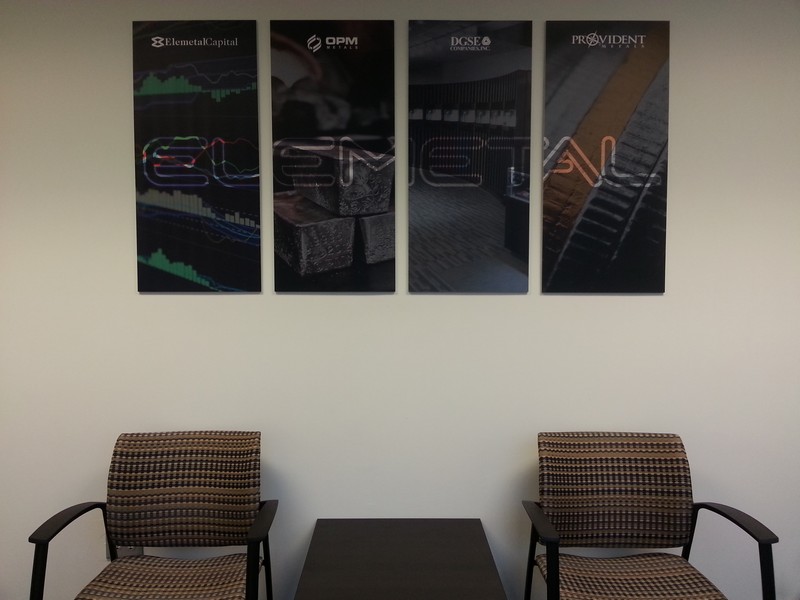

Yes sir. These were all done with Command Strips. The only thing you need to be mindful of is if there are any irregularities in the drywall. If it's too wavy, it will cause issues, whether you use Command Strips or VHB tape. Gatorfoam is rigid enough, that over time, it will pop either of those off the wall if there's continuous pulling pressure from the panel trying to return to straight.
