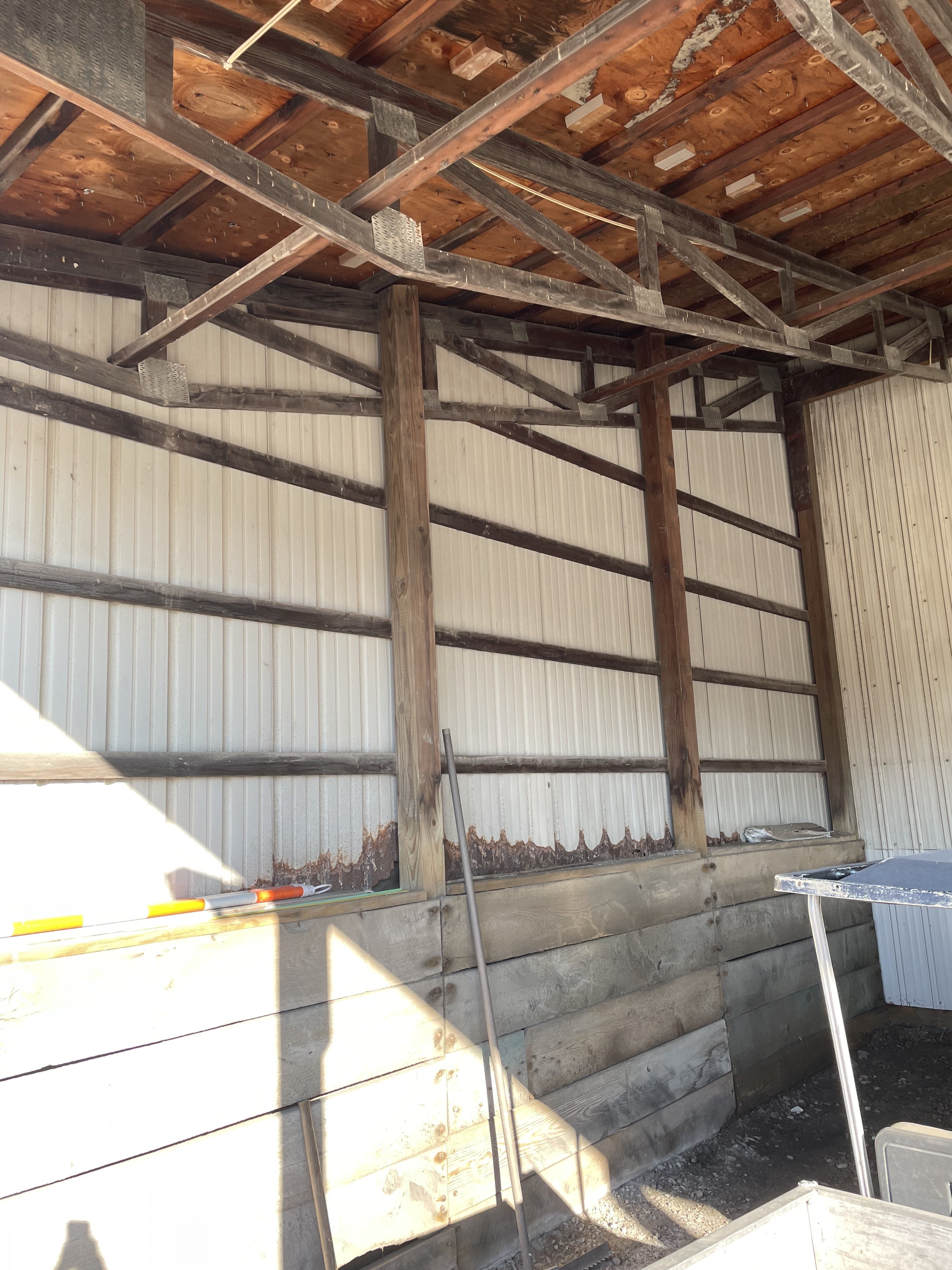

I'm looking to hang a large plexiglass irregular shape sign on a clients wall. This is the wall it would be going on. He asked for some kind of bracket to hold it into the wall. Does anyone have any ideas on the best way to hang it?

Is it going to be illuminated?
Are you trying to achieve a flush mount or extension mount?
would try to place your fasteners into the wood
French Cleats will use gravity and be easy to remove / replace as needed
visual800
if thats the wall why cant you not put it on any of the chosen wood braces and uprights, got more wood area than sheet metal
