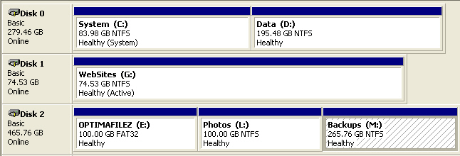

jiarby
How do I format the next partition solely for other software?
rt clik my computer
choose MANAGE
select disk management
select correct disk
rt click create partition
then, after the partition is created you have to format it
I have 1 disk for OS & DATA (partitioned 1/3 OS - 2/3 DATA)
