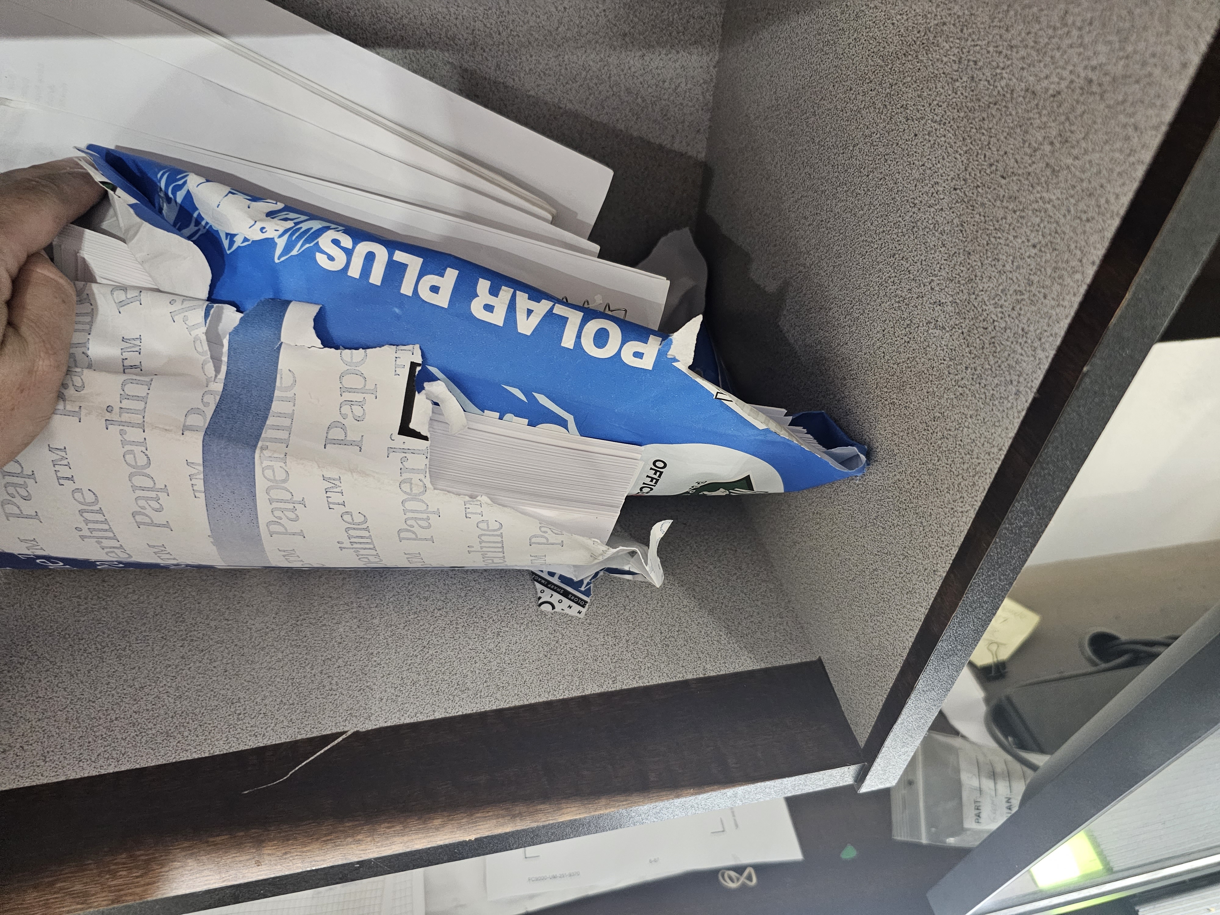

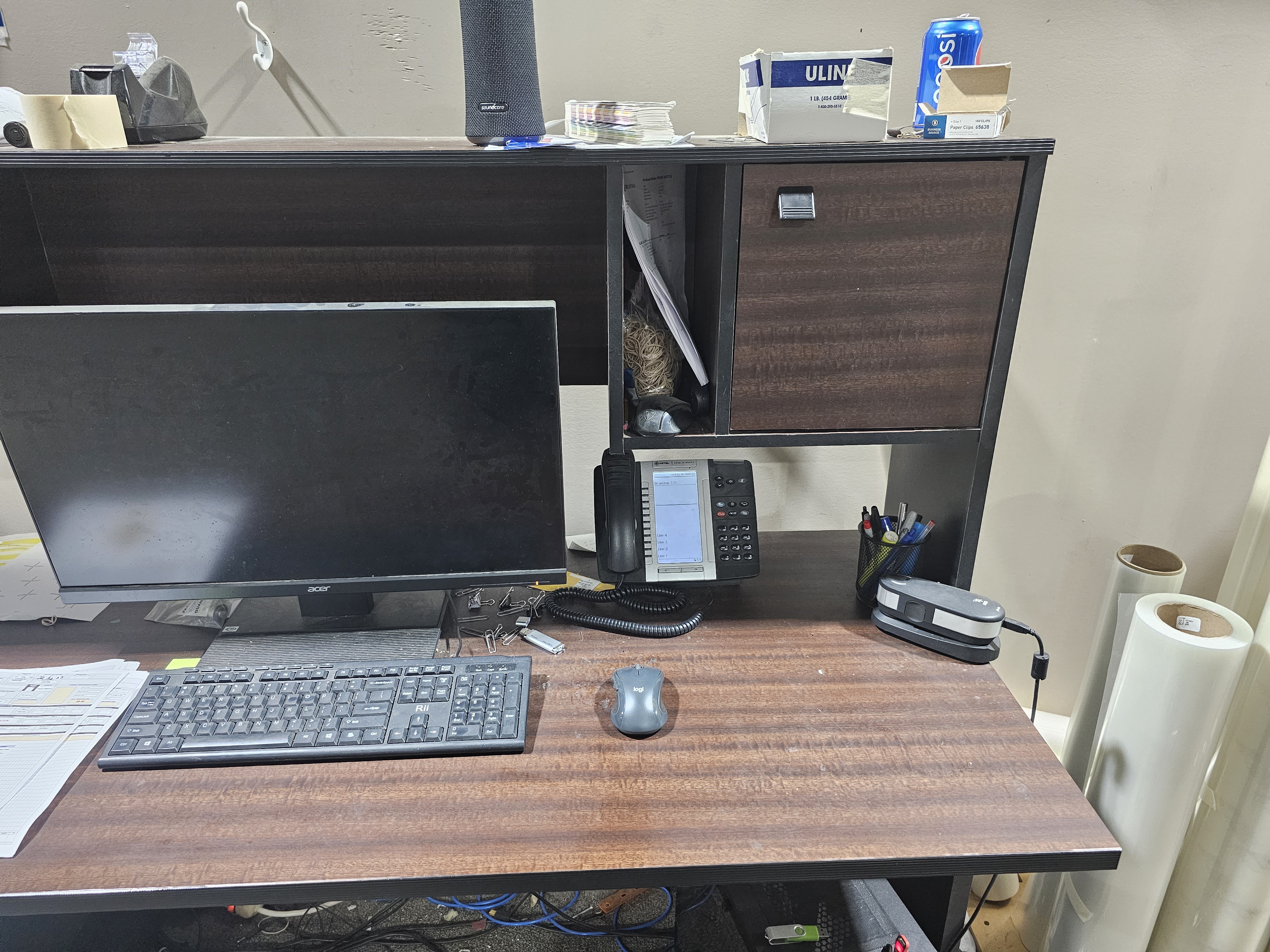

When I get into work today I will send you a photo of our work desk, I got it for free off of Craigslist and it was an old s***** desk that was made in the 50s... It had the suckiest pattern on it but we had some leftover dinoc so I wrapped it, it's been about 6 years now and there's not even a scratch on it, and we use the mouse on it daily.
It is expensive, and there are alternatives though... I've heard really good things about the brand that comes from Korea.... Bodaq I believe. I think it was about 60% of the price of dinoc , and considered pretty much equivalent
ikarasu
Not my desk anymore... So ignore the mess. The whole thing was this shitty marble pattern that looks like it's from the 50s.
We had some leftover.dinoc from a job so I wrapped it, just checked and I only see one scrape in the corner.... Which may have been my shitty install job

Six years should do it.
Logitec mice have those nice PTFE feet, but the bigger mouse on the right looks ready to take on any colour control action that might be hand to it.
