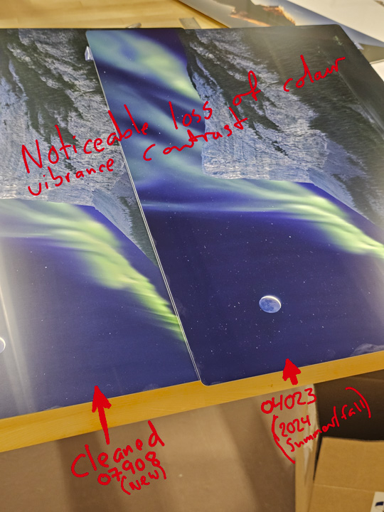

But now our last two received Semi-Gloss shipments have been of panels that come out of the press heavily fogged and covered in residue. The residue appears to be removed when cleaned with Isopropyl but the colours of the entire panel are visibly and measurably less vibrant, less bright and lacking in contrast.

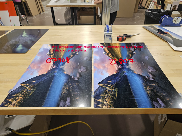

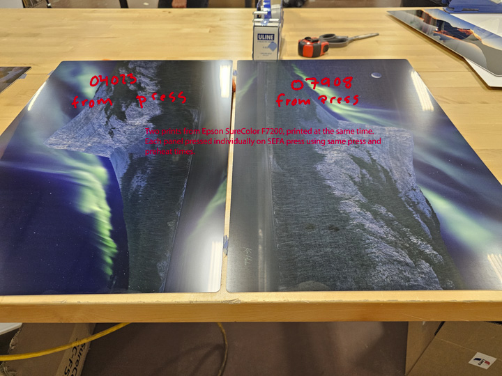

Testing the new panels against the few remaining older (2024) panels.
I printed identical files at the same time on our Epson F7200. Then pressed the panels individually using the same preheat and press times that we've been using for the last 2 yrs.
As pulled from press no Cleaning.
We've tried extending the preheating of the panels, extending the press time, shortening the press time and as of yet nothing we've tried as has made any improvement.
