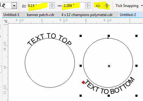

When you fit text to path, you can grab it and move it anywhere on the path you want, top or bottom of the path, plus there are invert and reverse buttons to move it to the other side of path and make it backwards and forwards. You can also pull it away from the path. The various distances are set by numbers in boxes on the toolbar as well.
