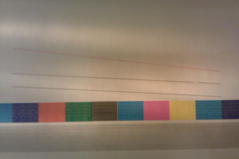

Yeah I dont like signwarehouse and use them as little as possible. But yeah the shim just puts a little tension on the cartridge, won't mess anything up. Fixed my color problem, still cant figure out my black one though!
dj_elite
Back up and running! Seemed to work. Thought the pump was dead and it turned up to be loose ink cartridges that don't fit properly......:/ Now if I can just get that one little spot I'll be all set.

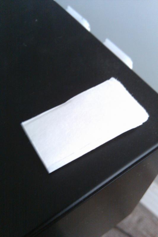

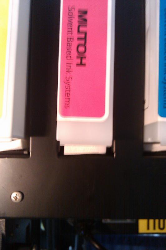

dj_elite
I just cut pieces of 1/4" foamcore board 7/8" wide x 1-3/4" long. Slide them in so there flush with the outside of the ink carrier and slide the ink right in on top of them. Make sure your printer is off when you do this so it doenst think your loading a new cartridge. Then I ran a fill cycle and two powerful cleanings, worked like a champ! First pic shows where they are under the cartridges second picture is a crappy pic of the shims I made

dj_elite
The installation wasn't hard, it was just figuring out why i wasn't getting any ink. I thought my pump was going bad so I replaced the tubing and still nothing. I figured I had used the wrong sized tubing or something. But I did this shim fix and everything is printing like it should. Printers been down for 4 days, not good for business :/
tomence
How did you align the heads, also in one of the pics where you said is working now i think the black head is little off.
dj_elite
Yeah that was before I fine tuned it. There is a screw that holds the black head in on the bottom. I loosened it and manually adjusted and then ran a nozzle check. I repeated until it was good.
