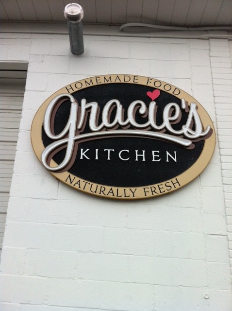

HDU carved and blasted sign

yes, I designed it- the logo and sign. I will post a pic of what someone else did for the logo before he came to me (was not happy with it)
The sign is finished in Mathews and 1 shot. Its 4' x almost 6'
Used aluminum L brackets 8 finished in matching paint.
Its hard to tell from pics but the name is 1" hdu raised off the background.
