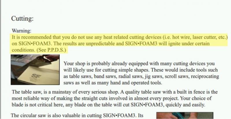

signage
I have found this since I posted my question.
george w
Burning eps gives off mustard gas as well as other toxins. Mustard gas was used to kill soldiers in the trenches in WW1. It burns the lungs and causes a very painful death from suffocation. It's nasty stuff.
