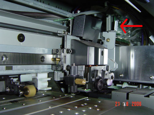

I'll be dammed, I can't find my manual and I need to adjust the head height on my 540 so I can run some 40 mil magnetic.
Can anyone tell me the menu steps?

I'm not sure what you mean be menu steps, because you do it manually. :help:
Here’s the lever you put up for high or push down for low. There are only two positions on the SP 540 VersaCamms. High - Low
Using the directions on the menu is just to bring the head out for ease of movement.
In VersaWorks, it is to let your profile know if you’re firing from high or low.
