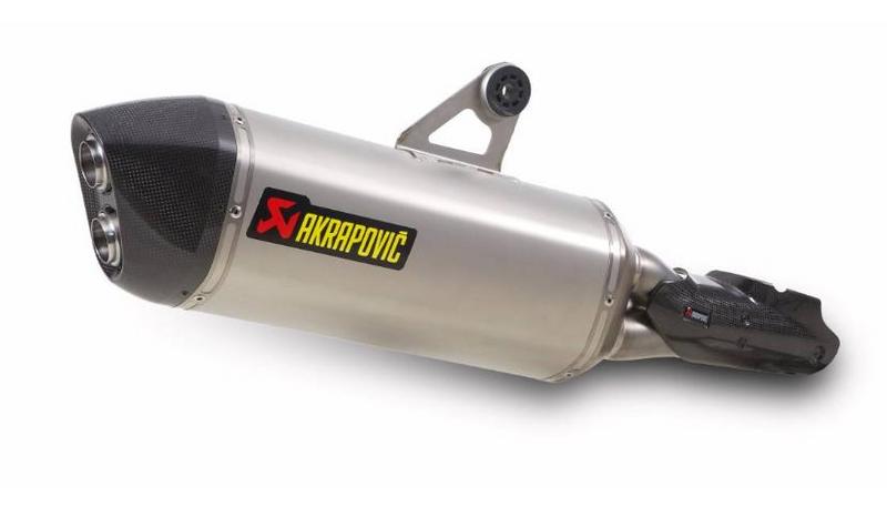

Is there such a thing as printable material that would resist heat of a motorcycle muffler (the exhaust can)
my best guess is 250F
The decals usually come with a decal that has a metal layer. I tried googling, but except for places offering decals, i can't find a material that's prinatble and suited for such application.

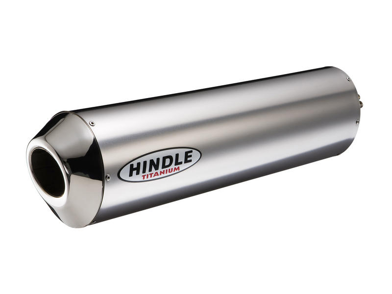

see attachment.

rjssigns
I'm not positive, but I think its just plain ol' screen printed vinyl. At least it is on my "Termi's" which are carbon fiber besides. One decal got a nick so I removed both of them. I'd think if it was hot enough to ruin vinyl it would eat the carbon fiber in short order.
Mine are similar to this and trust me the decal is nothing special: http://www.motorcycle-exhausts.co.u..._Can_KAWASAKI_ZX6R_200914--product--6103.html

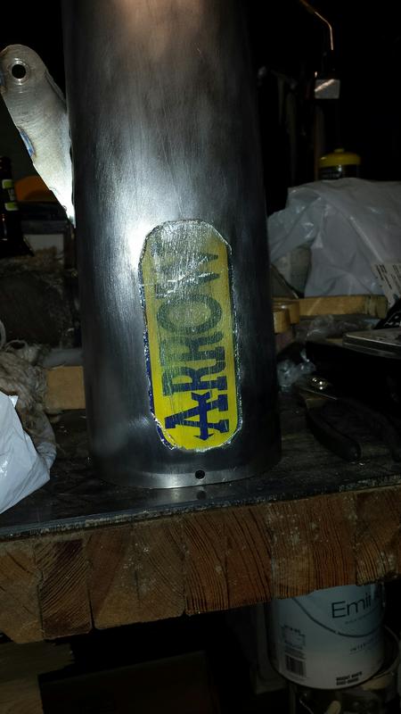

thus thinking wrap wouldn't withstand it. I'm sure my friend can find a replacement arrow on the interwebz, but he figured he'd ask me first.
so, do you think wrap or pvc would melt on that arrow?

I'd give it a shot. The "can" will stay a lot cooler than the tip. If you have an IR gun handy go for a ride then shoot the can in various spots. Should tell you what you need to know.

The stickers on my Akras were metal foil too.
No vinyl will stand that kind of heat for very long.

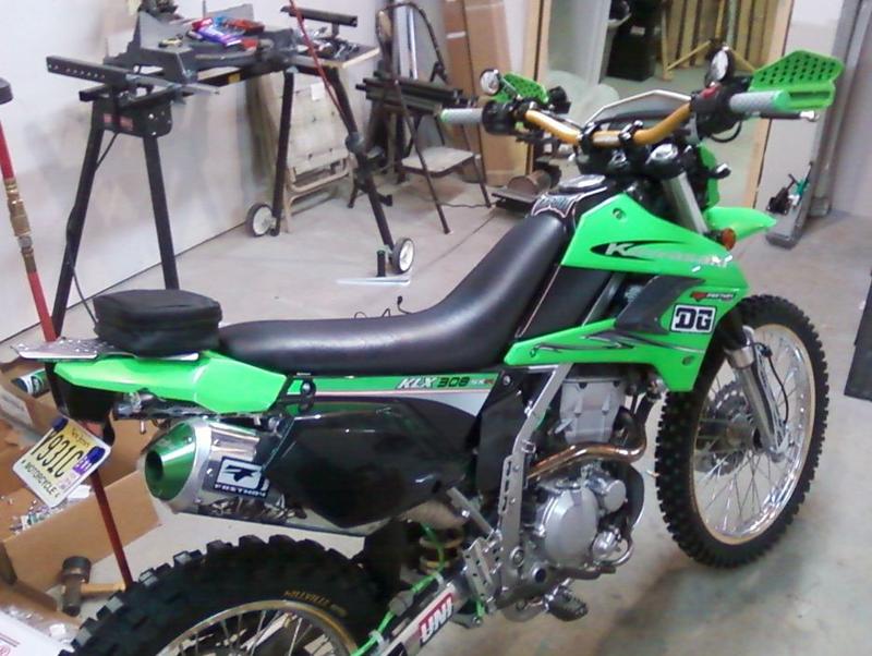

Orajet 3105ht
I used orajet 3105ht o my 09 klx 6 years old ad still look good bike only has 1200 miles on it
