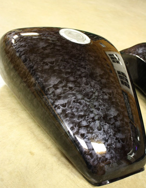

If you want to make good money With helmets and do them fast here is how.
you make yourself a Hydrographics Tank and print your own Hydrographics film using your wide format printer. No seams, no bobbles, spray with a clear coat and get paid.
I charge 350.00 for any design they want takes me about 35 minutes
Think outside the box- Heck just throw the BOX away!!!
Heck I do complete Harley Davidson fenders and tanks this way, plus Quads,
For a Harley I charge $1800.00
One day booked out doing motorcycles can pay over $13,000 for the day.
Just thought I would try to help on this one. Some times a sticker is not the way to go.
Made my tank out of a large horse watering tub.
Built my set up for under $500.00

Here is a Hydrodip Bike Tank.

For the ink and sheeting I would have to get that info for you. I have it on my Office computer sorry about that. I'm on vacation and won't be there until Wednesday.
As for the printer i use a old falcon outdoor by Mutoh that I picked up used for $325 on cregslist. was not printing ran a lot of cleaner threw it and she cleaned rite up.
