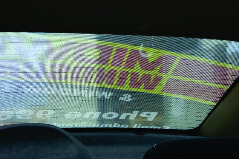

So I have a bit of a problem & I'm having a hard time trying to solve it! About 3 months ago I Installed LAMINATED Image Perfect (brand name) 'One Way Vision' to a VE Commodore sedan & a FG Falcon sedan. I installed them dry to an immaculately clean surface & everything went well, very straight forward. Now the owners have come back to me because they don't have a 'clear' view out of the window, & is kind of dangerous as all you can see are very blurry shapes!
I was supplied the product from a large Signmaking company in the City (as am in the country & do not have a printer myself yet), I have contacted them & explained the situation, as the first thing that came to my mind was that they have used the wrong laminate that wasn't 'Optically Clear'. Their explanation is that the windows on these two types of vehicles have a very sloped angle which decreases the vision through the holes, I've never heard of this before!! Can someone tell me if they have come across this?

Looks like no opt. clear laminate. I think they screwed up on that one and trying to get away without replacing the print for you.
Turfa
There is something seriously weird with that perforated window film. You shouldn't be able to clearly see the image from the inside of the car like that. What especially stands out is the white text. The back side of the film should be black ! I don't agree with the 'sloping glass' reason. Yes, highly angled glass will reduce the visibility through the graphic, but not give the blurry overall look that you have here. I would suspect (as you have) that they used a standard laminate & not an optically clear one...... Still doesn't explain why the perf film itself looks translucent ????

Well, since i am working at the shop right now i actually went and took laminated perforated graphics that we have ready for installation. Yes, it reduces visibility, but does not become blurry.
reQ
Btw. Just did full back window perf on 2014 Malibu. Window is sloped like crazy, but zero issues with visibility.
I agree here.... you should not be able to see the graphics from inside the vehicle...should look like a tinted window from inside...unless there is some new form of clear contra vision available

Yes the holes get smaller and smaller. But the vision through the holes does not get blurrier as you tilt the image more? The wrong laminate was used. If it were optically clear, yes you would still have a highly sloped window with minimum visibility but it would be clear what visibility you did have.

Wrong laminate. I think they may be trying to pull a fast one on you.
The optically clear stuff is much more expensive than regular "daily use" laminate.
Ask them to re-make and re-send you the printed graphic. Then you'll know exactly the kind of vendor you're dealing with.

like reQ said, thats very suspect one way vision...lift some off & see if theres any holes in it or if its just a printed clear vinyl which is probably breaking down in the sun...good luck
phototec
Wrong laminate
You can see the perforate holes in the photo, so I believe it was printed on transparent perforated window film like 3M 8176:
http://solutions.3m.com/wps/portal/...-Transparent-1-37-m-x-50-m-?N=4294964643&rt=d
However, I agree with others that it WAS NOT laminated with optically clear laminate, cheaper regular laminate causing the blurry view.
Although the slant of the window does make the round holes appear as ovals, that would NOT cause the blurry view looking through the holes, only an un-clear laminate can cause that.

I will be contacting the company I dealt with & demanding a refund or re-print! So frustrating when you can't get good quality products from reputable suppliers :(
