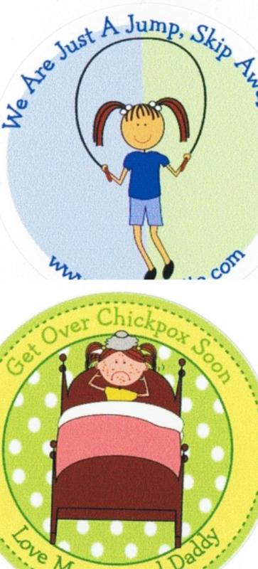

I am trying to test printing stickers using mactac 8300 pro vinyl. It's not a preference it's just all i have as the installer left it when he did the install of my versacamm sp300.
In november the prints to that material looked grainy/dotty but i wanted to focus more on other types of printing.
Now i am revisiting the idea and find that not matter what profile, setting i use i still have grainy/dotty print outs. I tried printing on a "gmi wall vinyl" the same graphic and it was "also grainy".
The art is 300dpi designed in xara and exported out as a jpg and then imported into corel x3, contour cut added around it and then exported back out as a eps.
Someone suggested it could be heat settings but i am not familiar with dealing with heat settings. It was never covered with the install and i don't know where to go to learn about "what heat settings to use" for which vinyl so any suggestion would be greatly appreciated.
This is an example of the prints. Again i printed on a "mactac 8300 glossy" vinyl using a mactac profile. And i tried printing on some gmi wall vinyl material with a solutions opaque vinyl. I have tried 720 x720, 720 x 1440 and 1080 x 1080 settings and still get the grainy look.

Put your print heat at around 28deg c, and pre-heat at 27 or so. I'm not familiar with that machine, but thats a good place to start.

Well, I am not an expert, nor user of wide format printer (acctually - I am user wannabe :{). hopefully soon), but i've done a lot of research, and I did see samples from VP 300v. Here is the deal:
Your printer uses Epson print heads, a little older in manufacture (there is newer generation), and while it is a good printhead, capable of quality printing, it still has smallest dot size of 5 picolitres, meaning it CAN BE SEEN from smaller distance. (compared to newer heads putted in Mutoh and Mimaki printers, with 3.5 picolitres dot, which makes prints look a little smoother).
Now, U will probbably be more happy with it's printing when it comes to designs that has photographic elements, or clear colors (basic - CMYK), or colors with at least 2 strong basic colors in them (0 100 100 0, 100 100 0 0 and similar). Reason - when a color is mixed from strong percantage of individual, basic colors, it is harder to see mixture-grains. But, when U use light colors, when all ingridients have small percentages, grains MUST be seen (logical: lighter color is achieved by making dots spread, and Your dots are a little bigger, so - there U go).
U should check if Your printer prints better something else, though (0 100 100 0 red color 4 xample), just to be sure if it is true what I said upthere :{).

i have experienced that with my versa camms and we keep the heat at 40 degrees for both printing and drying and it works great
also make sure the area you are printing on is clean when you first open a roll of vinyl the first foot or so can be dusty or have finger prints also when the vinyl sits for a while it gets dust so you may have to go in a foot or so but i believe the heater is the issue

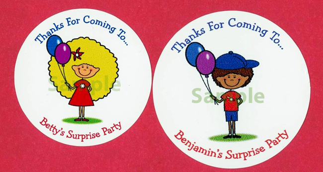

Ok wanted to come back and let you guys know that I have sorta solved my grainy/dotty issues.
I never got to plan with my heat settings as i decided to first "upgrade to the lastest" version of versaworks as i had 2.6.1 installed. So figured that could be part of my problem.
After "upgraded" i couldn't print anything to versacamm. A lot of surfing on various forums i saw a someone had posted about the new version not liking corel draw exported 'jpg' files. Turns out it doesn't like "anything corel draw" exported as eps. To me a whole day to figure a work around. I have illustrator so i tried using that to make a contour line, etc. and was able to sent stuff that was eps to the printer.
To make a long story short I've spent the last 2 days dealing with software issues. I made a breakthrough yesterday and so i printed 2 files that i show below. One was using the profile that is specifically for the vinyl i was using (GVCP) and the other i forgot to select the "profile" so it printed at the normal "Generic Vinyl Setting".
So you can see it's a big difference.
If you look closely at the "hair for the girl" you see it looks like dots i figure it's how the ink mix to make yellow but her dress, the balloons, etc. are all sorta smooth. She was printed at "standard" quality. I can live with this print. Before i was getting closer to the boy but a little less grainy.
Anyway, thank you all for you help. I will play with heat setting now to see if i can get even better results for the girl.

freedommailing
Freedom Creative
