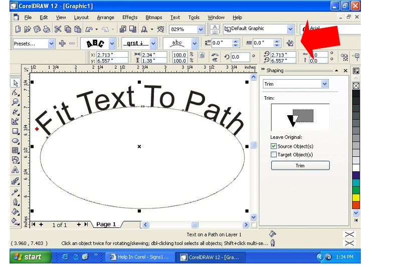

In Corel 12, after I type the text and make the path, and click "Fit Text To path" under the Text thingie drop-down menu, and the text goes to the path, then you look and see in the toolbar which shows up next.
That toolbar allows you to select where/how the text goes. The part by the arrow in this quick pic shows where to reverse text direction.

...and Corel 9 has the same feature. I think if you double-click the layout that toolbar pops up, just look for the mirrored "A" icon on the far right.
