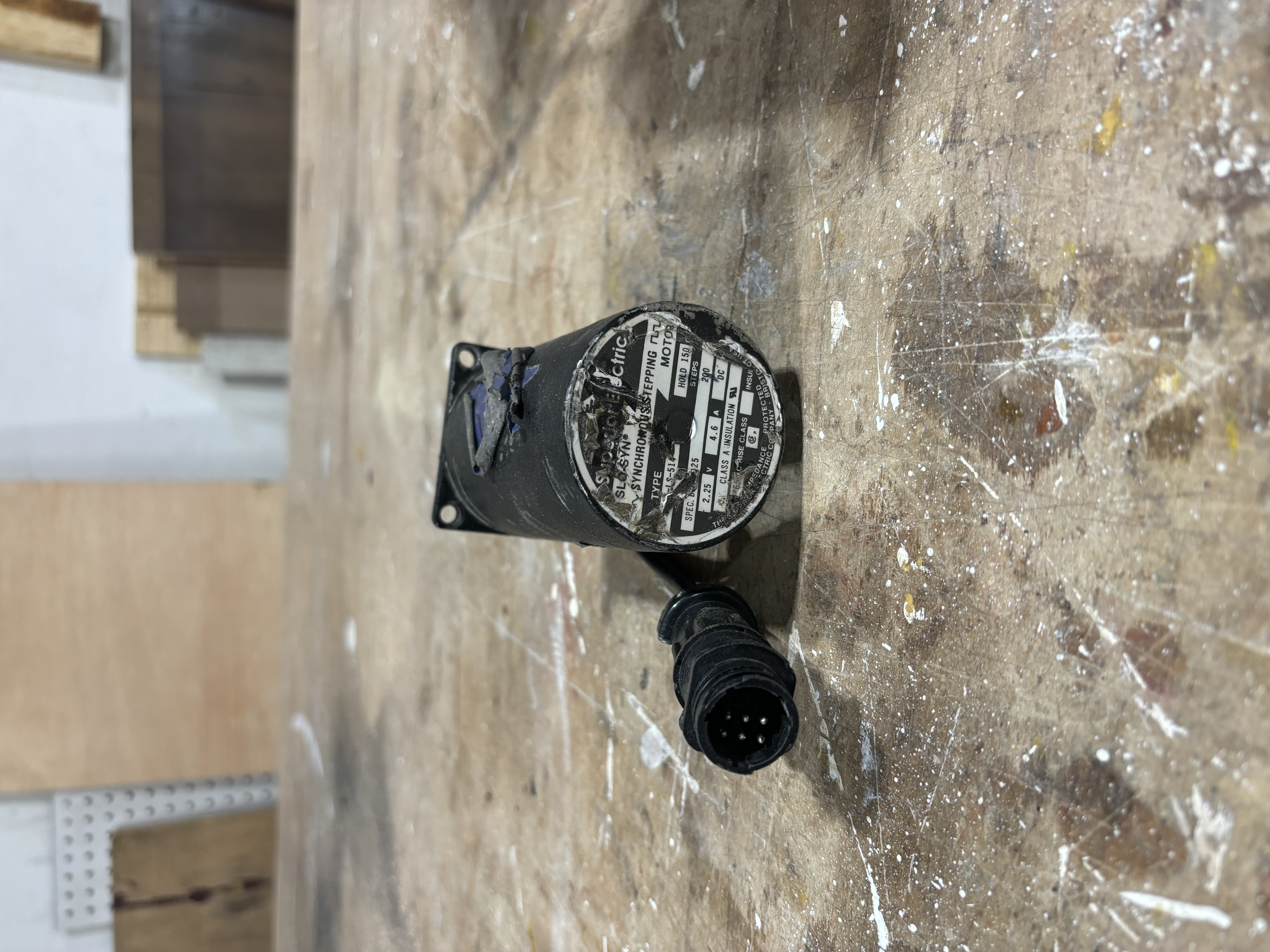

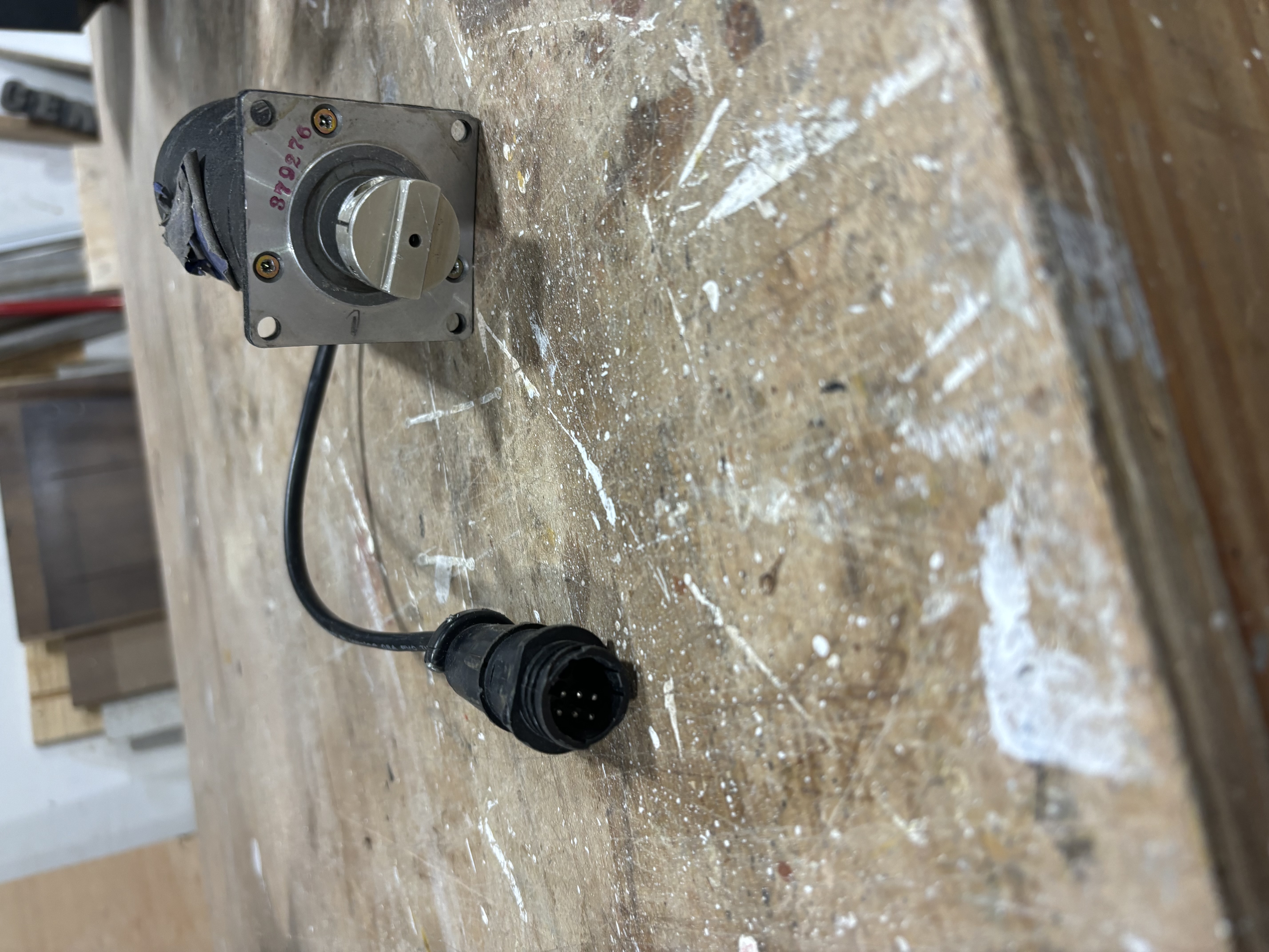

Here's a few pics

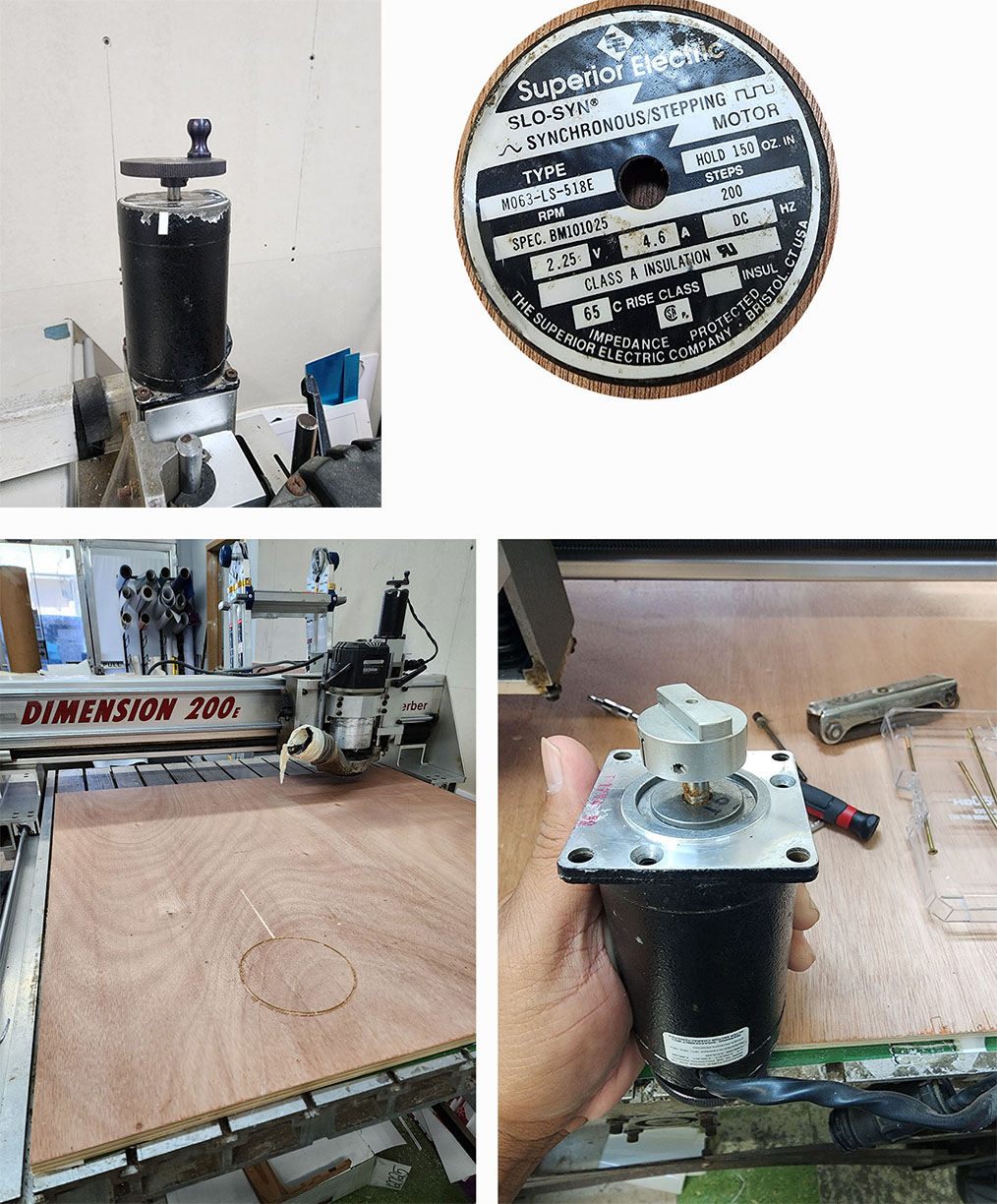

These are simple to replace, you just need those values on the label to match a new motor. Brand doesn't matter, exceeding the hold value of 150oz/in is fine, but voltage, amperage, and steps per revolution need to match. You'll also want to make sure your new one has a long enough shaft of the same diameter, but otherwise it should just be a nema 23 motor.

Looks like a standard stepper. Just measure the mount to tell you what size, then find one with the same shaft details. Should be either 4,6 or 8 wires depending on the type, but they all connect to 4
