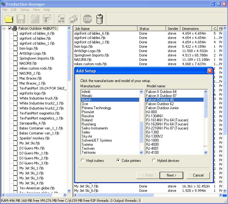

Open Production Manager, Click on Set up, Add Setup, Select printer at the bottom of screen, then find the printer you wish to add.

I Dont Have The Icc Profiles Cd, I Download The Icc From Mutoh, I Have Flexi 7.6, The Production Manager Only Have The Plot For Cutter When I Try The Install The Printer. The Print Server Is Ready, I Have Ip Address, The Only Problem Is A Driver For Mutoh.
Steve C.
You need to call the place where you bought the printer. Is it new? Did you try what I said? Flexi has drivers already installed for all major printer manufacturers. The driver should already be there if you just go to set up in production manager.
