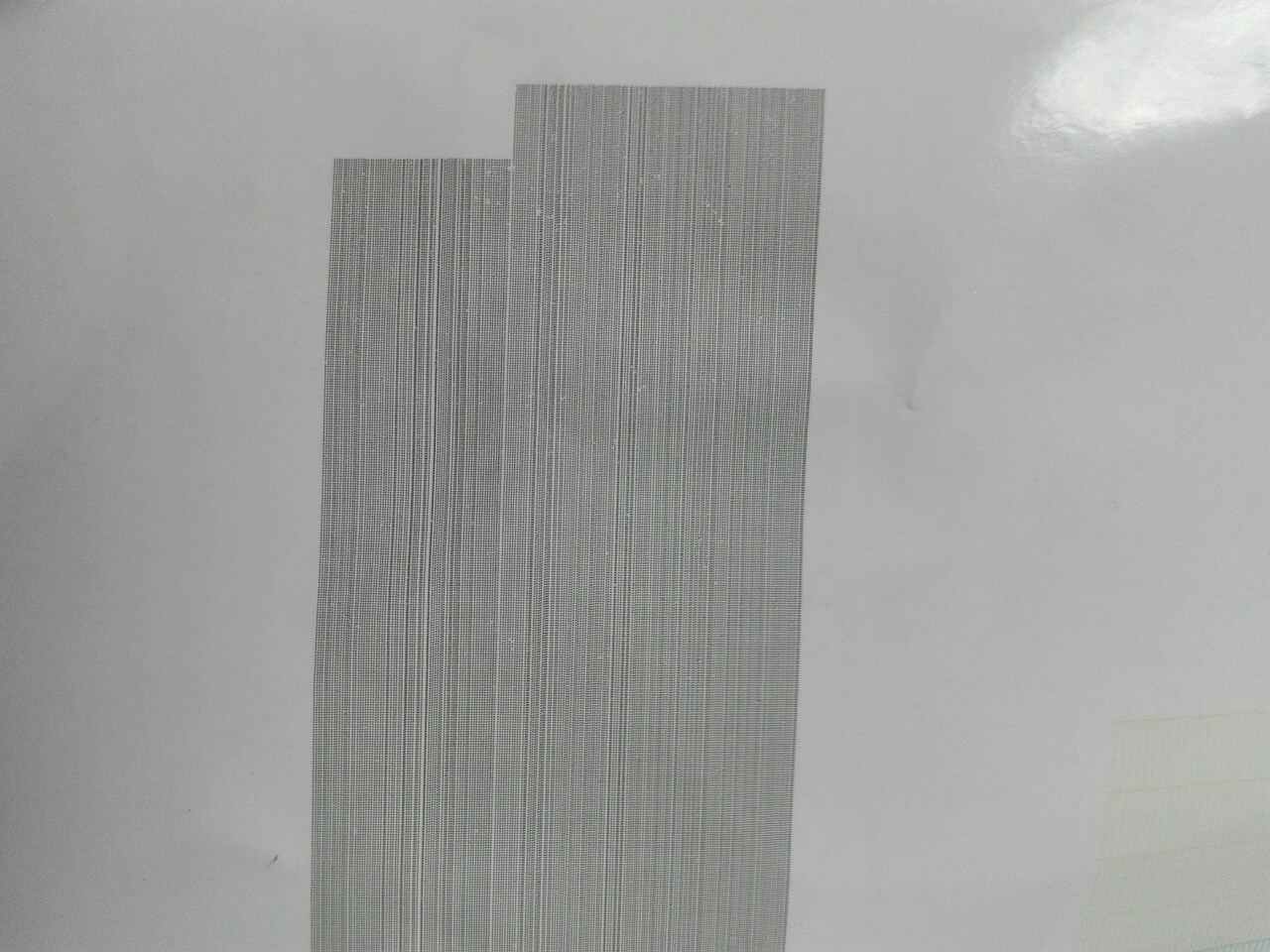

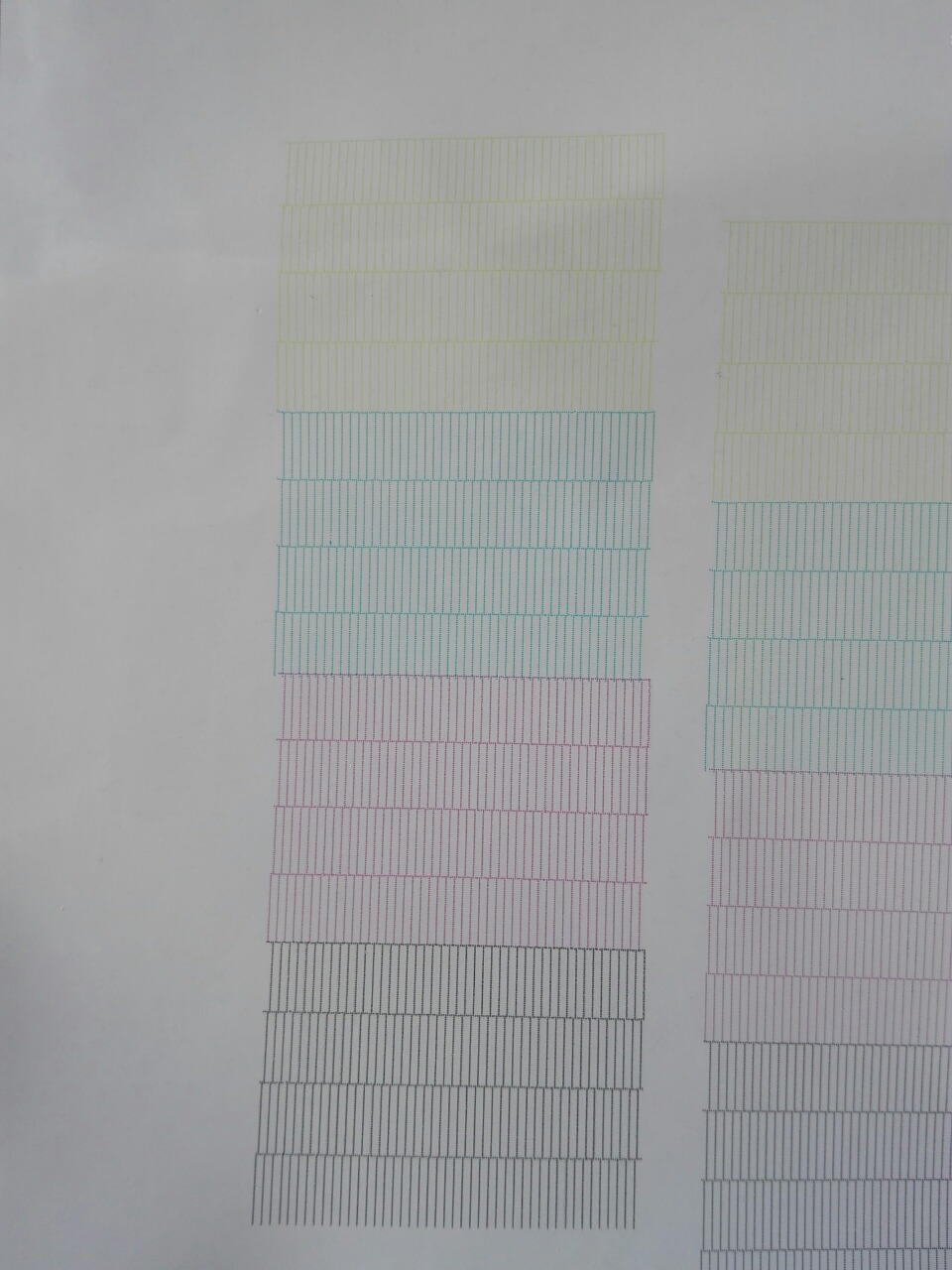

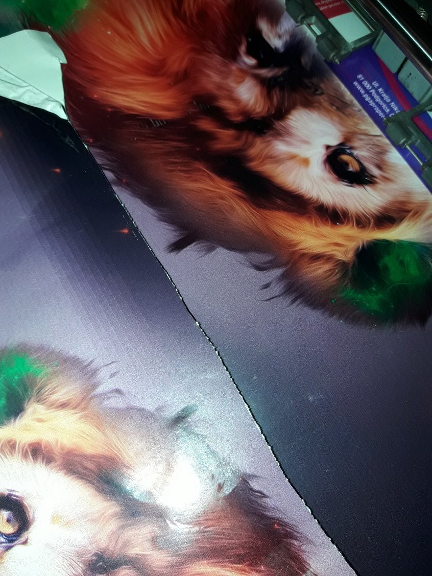

I have this problem, someone who can help me what's the problem?

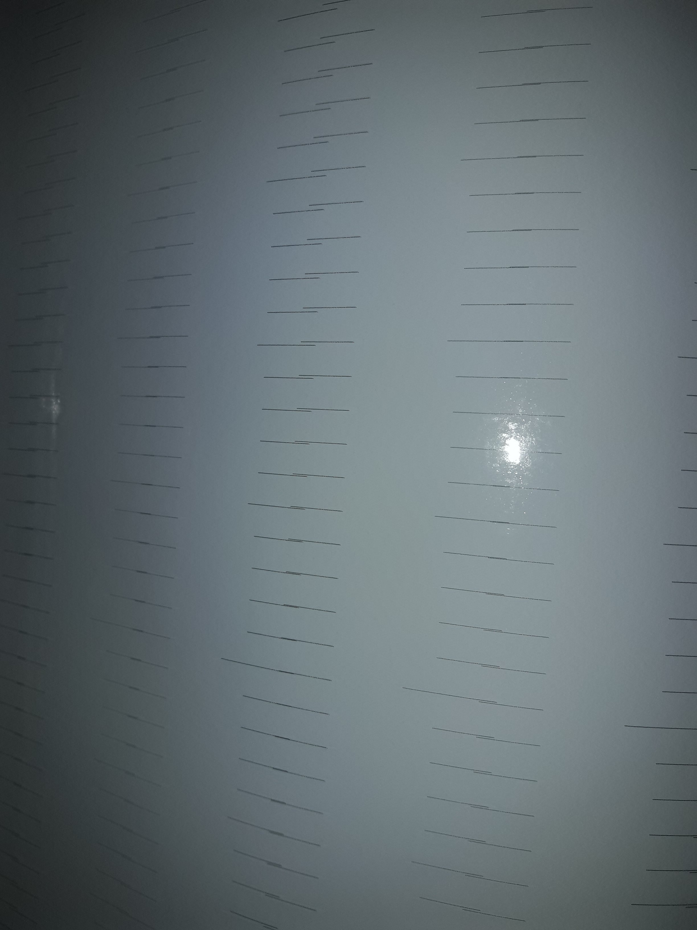

zex123
tnx blackthorn i cleaning the encoder strip and sensor,
now is much better but not completely , if I buy a new strp? or tray something else?
pic after and before cleaning strip
OmegaAdv
he mean feed compensation - my is around 60. you have to get a good colors without banding. Try when you print to click function button and change the value.
With what parametres you have print the 3rd image. Resolution passes?
If you have better result buy new strip.

3rd image is print mode high quality 720x1440 16 passes

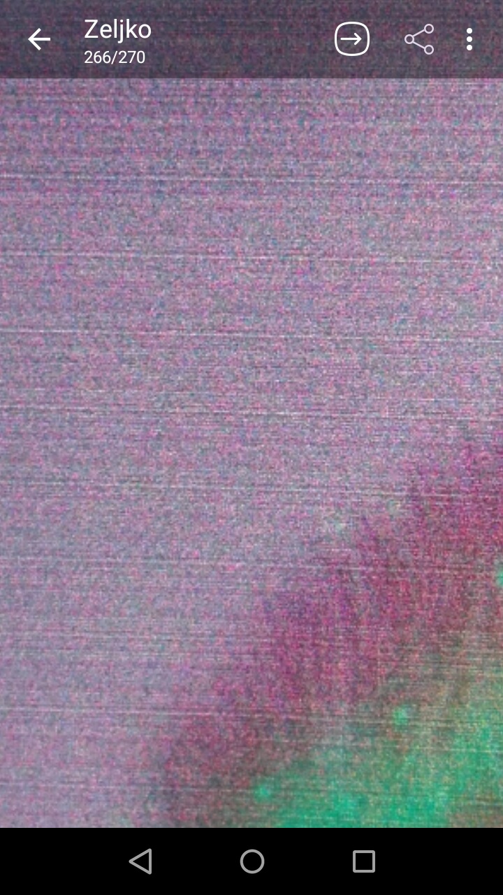

WHAT now? thank you so much for helping me :)
thin or thick what is?
