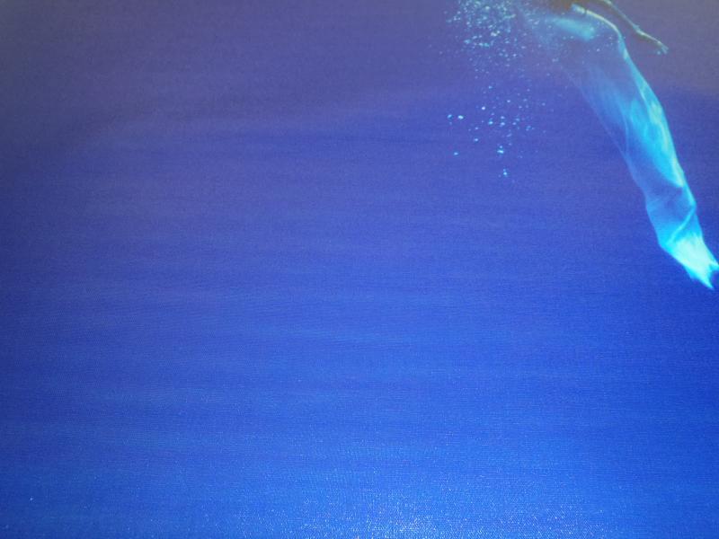

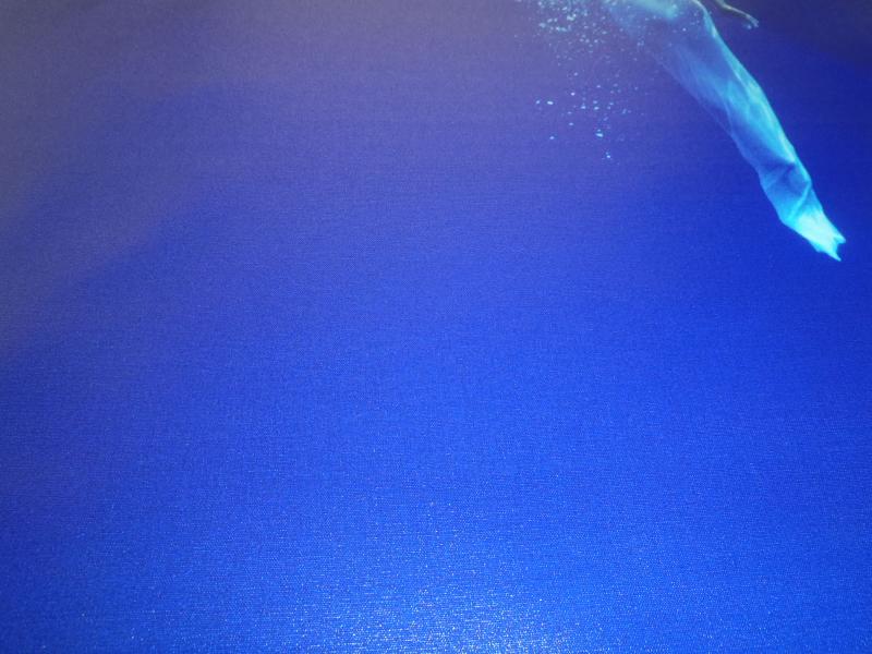

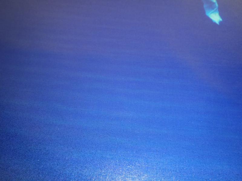

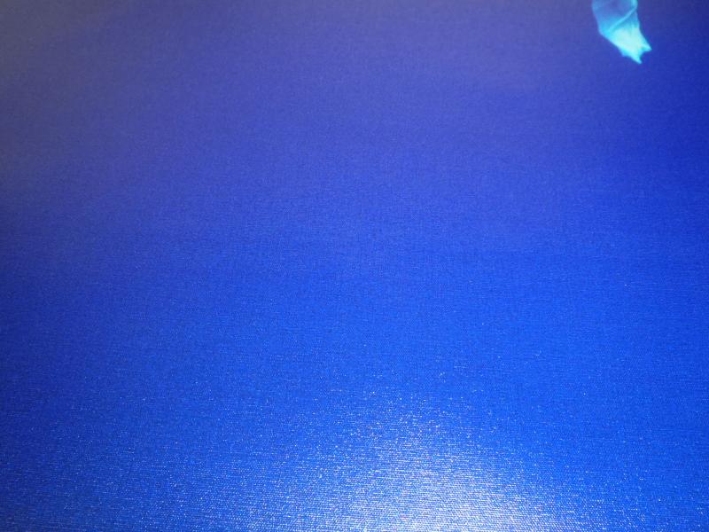

We have a JV33 - brand new only 2 months old. Since we got it we have been having banding problems. Our supplier that we bought it from doesnt seem to know what it is yet. Its been a few weeks now and so I'm posting to see if anyone here knows what i should try.
The head is new, and all the nozzles are firing. We tried turning the heat setting all the way up and also all the way down but still get the same thing. We are testing on Glossy Canvas (made by epson). We printed the canvas at the suppliers shop using their demo unit and it printed great, using these settings:
720x720, uni-directional , 16pass
same settings at my shop but i get the ripple affect - see the pics.
we calibrated and comp multiple times before printing-
any ideas? these are to go into a art gallery so we want to get it looking just like the suppliers mimaki.
thanks!!
Pics are
1. HD pics are our shop print
2. One Shot is the suppliers

kkamauu
we also get this on our 3m control v3 as well - ill post pics as soon as i get some -.

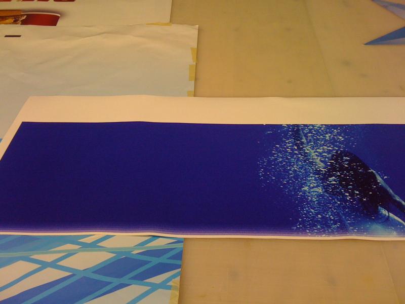

fixed!
GOT IT !!!! Thanks GUYS -
540x1080 6 pass worked -
plus i added a little more saturation and the print comes out beautiful.
thanks for the suggestions - !
