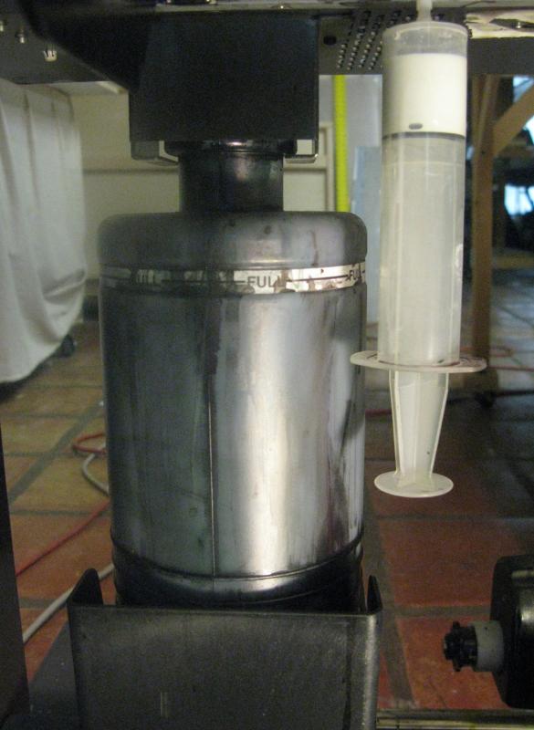

yes, you will definitely need some syringes. not all syringes are created equal. ones that i've got from supplier like solventinkonline are very hardy and can develop trememdous vacuum/pressure. others from tractor supply for veterinary use were horrible.
the white ink is nasty. i use it a lot. but when done, i flush the lines (or occasionally flush). if possible don't run it directly in the machine. my direct factory lines are running cleaning solution. and i run white and clear and soon silver outside the machine.

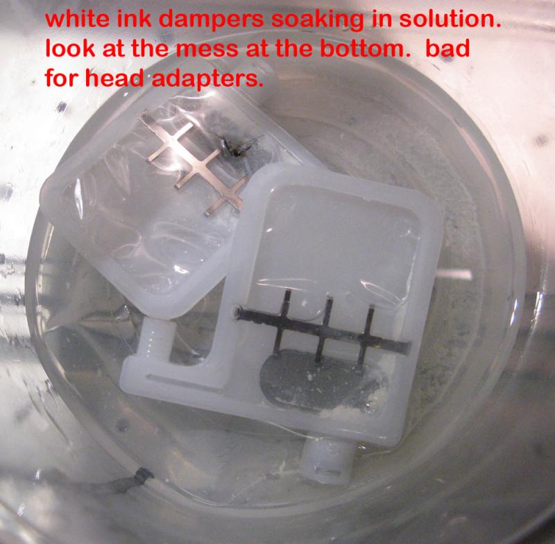

to clean those tubes, you'll need a good syringe, some MEK (add a little reducer/retarder butyl cellosolve or something similar). get a clear cartridge fill it will the MEK. (the MEK is much more aggressive than cleaning solution. it won't hurt anything from your ink tube to the clear cartridge. but don't put it in your head carriage/print heads etc.) pull off the line to the damper pull and push the fluid back and forth inside the line and hard as you can both with the syringe loaded with solvent pushing, and pulling from the cleaning cartridge side. be carefull when pushing. the syringe tube could burst off the syringe and you might blaze MEK all over your slider board if not careful. also, get a small wire and feed it down the tube as far as you can from the head carriage side. many of the clogs can occur as the lines head up and over to the head carriage. if all else fails, you'll have to replace the ink tubes. it's a bit of a task. but not rocket science. just basic knuckle busting an cussing. two hours and you'll be done. also, if you are running white always keep an extra head adapter around. the white ink can easily clog the much finer filter in the head adapter. (check out the pic of the dampers, that is the crud that your printer is full of right now).
keep in mind that white ink has solid titanium oxide particles. if these things settle, there is no solvent that will clean them off. they are inert.

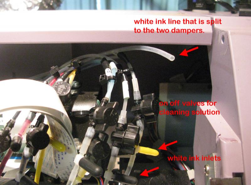

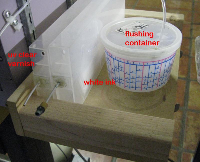

attached are some pics of my white ink work around. it's primitive. and will be upgraded with better valves when business calms down a bit. but for now, it works well. and the machine is happy.

to reroute the ink outside the printer is really easy. really. the main concern is getting the outside cartridge shelf at the right height. each 1/2" up or down adds or subtracts from the siphon effect.
the first time i set my printer up with the white, i didn't do a very good job of flushing the line. the line was ruined by white ink plaque. flakes coming off everywhere. so don't let that line go dry, or it will be ruined. like i mentioned, a solvent can't help the line get clean at that point. now i clean the line out until it is milky/translucent/clearish, leaving no build sign of white residue.
