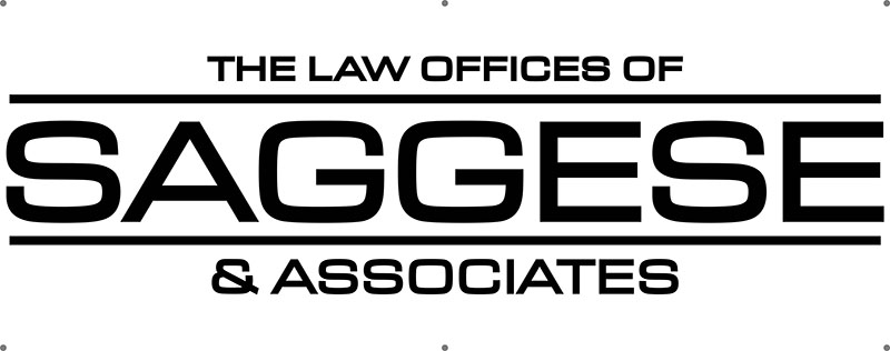

So my local guy backed out after agreeing to the job and taking a deposit. i need someone who can laser etch a 30' H x 72" W piece of 1/4" acrylic with polished edges. We are lighting it with a led strip and it needs to be full etch. I have attached a sample of what we need done. The grey circles are for standoff holes. I need a vendor that can do this ASAP preferably on the west coast. Can anyone connect me to such a person.

Most laser owners don't have that sort of capacity, unless they have pass thru doors, which only a brand or two have, and that's the wrong way to do that job with the lines all the way across like that.
Kern makes a large laser that would do that easily. Call Kern tomorrow and ask for someone in your area with one of their machines. I'm sure they can help you.

All good thoughts I will check Bane. We had a sample made up with just a router and it looks awful all kinds of swirl marks where the bit starts and stops. As to sandblast we don't have that capability so I would have to find someone. I also don't know how the light would diffuse through sandblast I would have to get a sample to check. I am new to this and this is a monster of a project. A couple of people are at SIGA today and maybe they can get some answers.
