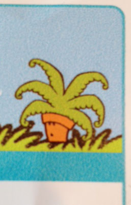

timstudio
What I'm really interested in is the sharpness of the prints made by the roland for non gradient or fullcolour images. For example two coloured bonnet stripes as seen on the mini coopers. Is the summa superior in this area, of is the Roland 'just as good'?
From what i have seen so far the prints by the roland look very good at a distance but from real upclose a black line for example is kind of..well a non sharp black line. Again, this is from upclose. Seen at a distance it looks like a sharp black line. Also spot colors have from upclose a lot of 'spickels' in them. Also here from a distance no problem.
I guess this has to do with the fact that its printed on vinyl? Or are the smaples provided to me just poor, though I asked for samples where the machine performs at it best.
I really lean to the Roland because I can buy the Roland with a lamintor for the same price as the DC4sx without the laminoter. And the inkt is cheaper than the ribbons. Than again, if the Summa would swipe away the Roland for my needs than the choice is easy.

FrankW
The SP300i don't print with spot colors as the DC4 does. Setting up Spot Colors in the graphic software and map them in VersaWorks is not the same as print with a ribbon of that color itself.
"Spickels" arise on every media as soon as colours are mixed with other than 100/100-relations. The printers do not create reduced color tones with creating a lighter coverage of inks, they create reduced color tones with dithering.
This happens with the SP300i and with the DC4sx, and the "spickels" on the DC4 are much rougher than on the SP300i. The advantage of the DC4 is that hundreds of colours can be printed without "spickels", as solid colours, with using spot color ribbons and so-called DuoSpot-Colours, where 2 Spot Ribbons are overprinted.
Except this, the prints are immediately dry, much more scratch-resistant than prints with the eco-solvent-inks, the prints can get an additional protection for more chemical and mechanical resistance during the printing process (Scratchguard), and maintenance costs are mostly lower than on the SP300. White printing - what a SP300i can't do - is in opposite to eco-solvent-white longer-therm-outdoor-usable too.
The main disadvantages of the DC4 are that you can print on real flat media (mostly vinyl) only, that the printer is very slow as soon as multiple colours are used (they will not be printed all on the same time), and that - because of the ribbon width - the borders of the ribbons can be recognized in prints even if correctly calibrated.

timstudio
I know little to non about the printing side of the business right now. Though I learn fast :)
The prints were not made by me but by the company selling the machines (a respected company.) The time I was there to gather information about the machines they made some prints for me, but this was done fast just to show me the machine (Roland) in working order. Since I had serious doubts about spending a lot of money whit the examples provided I asked them to send me better (the best possible) examples. They did, an some were on both fast mode and quality mode to compare results. This let me to my starter post because I was and am still a bit disapointed about the print quality.
What I don't understand is that I never read negative comments about the print quality of these machines. Are my expecations to high? The photo I posted a few post earlier is done in quality mode. I understand that if the original file is not of to high quality, the print will be also.
Whenever I look at a car decal on a parkinglot etc that is done in fullcolour (or multiple colors) it looks sharp..real sharp. What I have seen of the Roland looks (again unclose) not sharp and grainy.

FrankW
Perhaps you have seen cutted graphics out of coloured vinyl.
