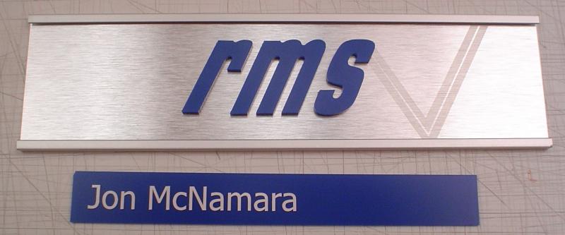

One of my customers is requesting that we make enough of these to make it
worthwhile (and it seems like another niche for us as we recently installed a
CNC). Can anyone ID the materials? The extrusion that holds the larger panel
takes a 2" slide in panel which is brushed alum and .025 thick. The RMS is
made from 2 layers of the material the name plate is made from- a clear plastic
with a very thin blue layer on the back and satin finish on the clear side- this
plastic is .067 thick. I suspect these are common materials but I have not seen
them. Can anyone help me? Thanks Gene
PS the name is cut vinyl and the checkmark on the logo.
J Hill Designs
JRS extrusion, 1mm sintra w/blue vinyl overlay for the RMS, .060 glarefree polycarb w/vinyl backer for nameplate? metal slide in .040 wrisco brushed?
